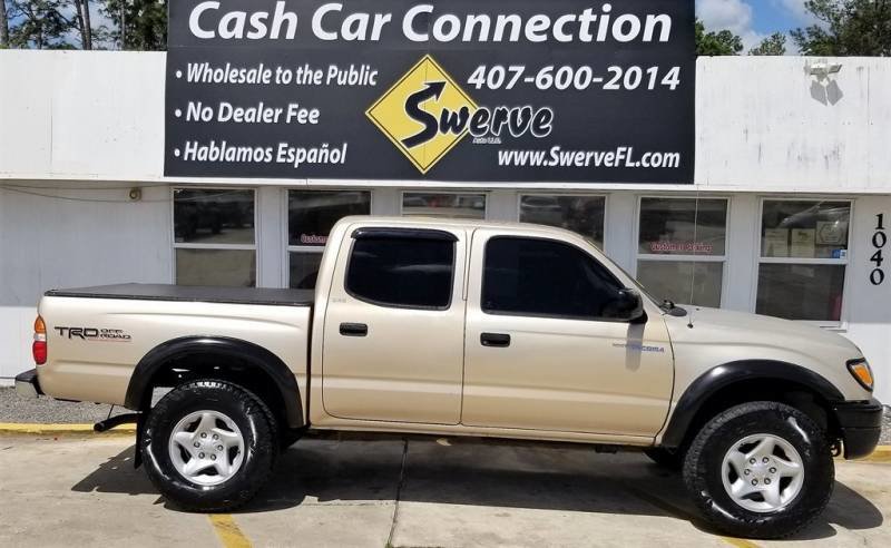

    sorry for my Ignorance but how can I check to see if the locker works?
  5. Apr 25, 2021 at 8:49 PM
    Kwikvette
    Feb 27, 2019
    #284735
    79,971
    Fresno County
    4 run, 2 don't
    Cool thing is, the driver side visor will actually have an instruction card on how and when to use it.
    Next, you ensure it has a diff locker installed by not only seeing the switch next to the steering column (the blank switch in the pic you posted, to the right of the dimmer), but also locating the actuator on the rear differential itself.
    For 4x4 models, you must be in 4LO to engage. Sometimes though, the rear axle shafts/diff aren't aligned to engage, so moving forward while turning the wheel one way or another will get it to engage quickly.
    *You do not want to have a rear locker engaged while turning on a high traction surface*

    Interested why you think it has a locking differential? It is not mentioned in the ad at all.

    OP is probably unaware of what the button is for in the picture he/she provided.
    Yes, one could've easily googled the answer (something I'd recommend as well for something so easily), but it doesn't hurt to answer once in awhile.

    The OP is likely going off of the pics of the bedside stickers.
    If the truck had come from Toyota with the TRD package, it would have had these stickers on the bedsides. Since we can see that there is no diff lock dash switch, someone has added the stickers to make it look like the truck is a TRD model.

    yea it gets people alot... i'll still never forget the truck someone brought in to work.. "customer states 4x4 doesnt work"... pull up the vin.. it said it was a 4x2.. but someone had installed TRD stickers, a 4x4 switch that was plugged into nothing. and that was it.... dude got scammed..

    They did a crappy job too. Placed much too high. Should be inline with the brake light not the turn signal. For future reference @White TacocaT
    yZ_7V06STSx8gIvkNuY2X0fyqTqhNI3OcFz4cCFr_795f8225e77f15c3bc10c9fdcf004571ddf83809.jpg
    Also should have this sticker if equipped with a diff lock (which it doesn't) -

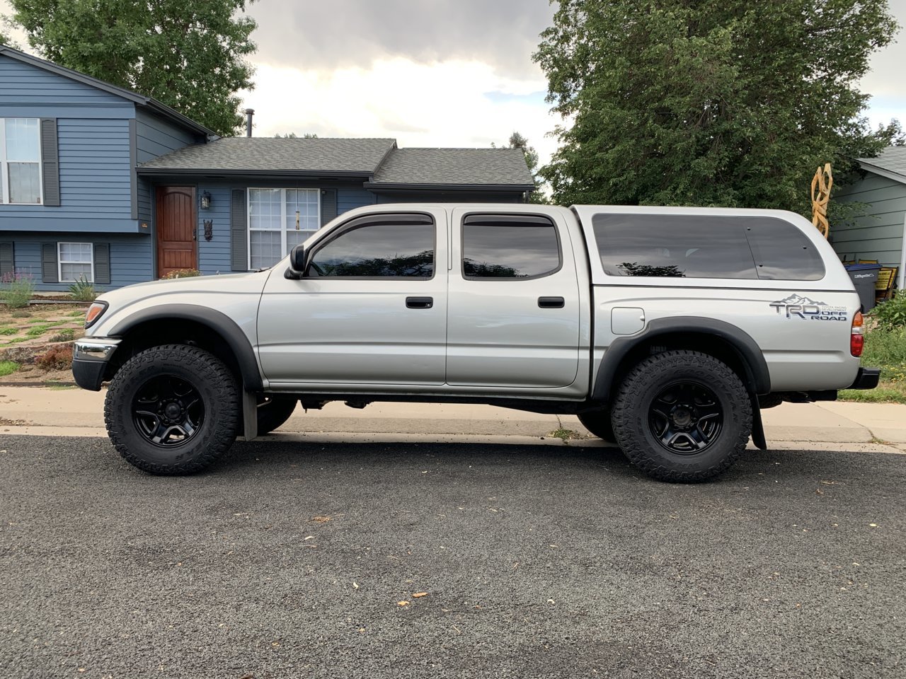

    Not to mention that decal is way off in terms of stock placement. It’s too high.
    Much like the previous owner of my truck who put the decals on in a bastardized place
