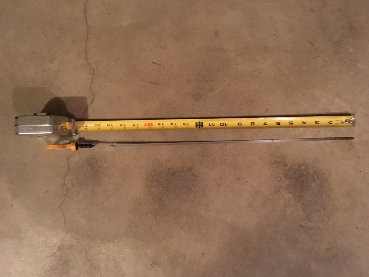

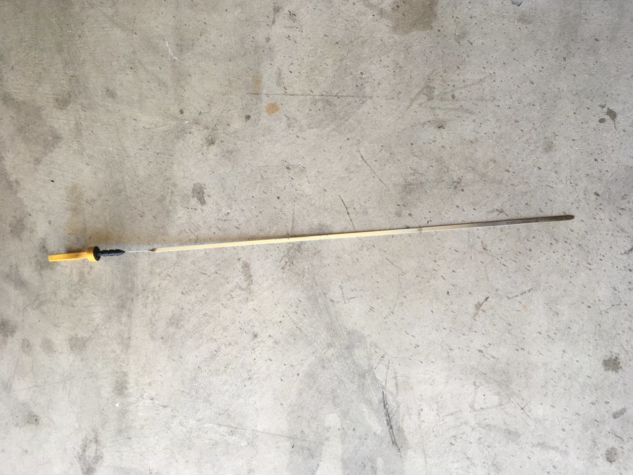

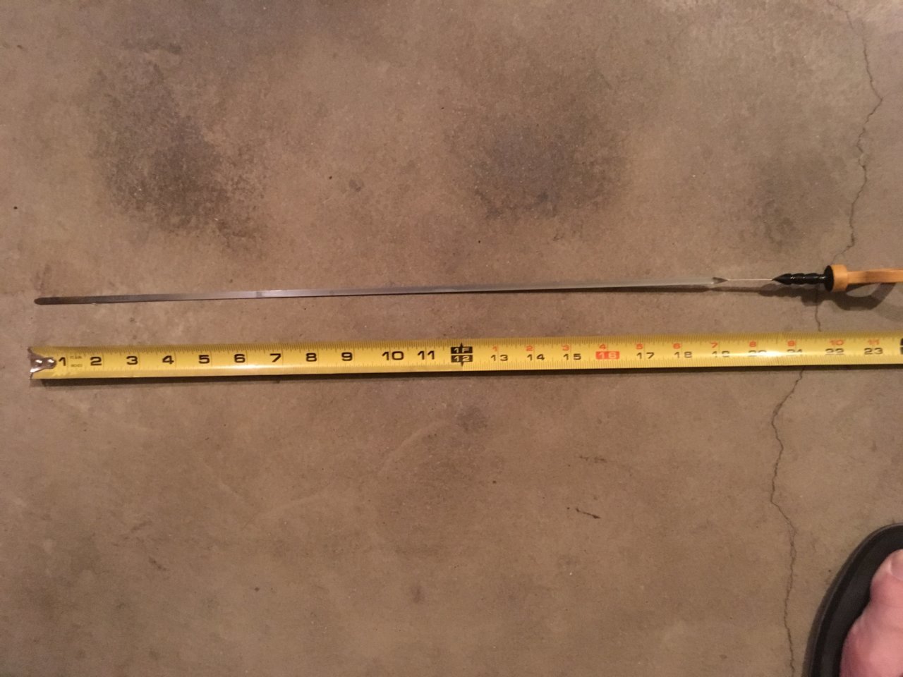

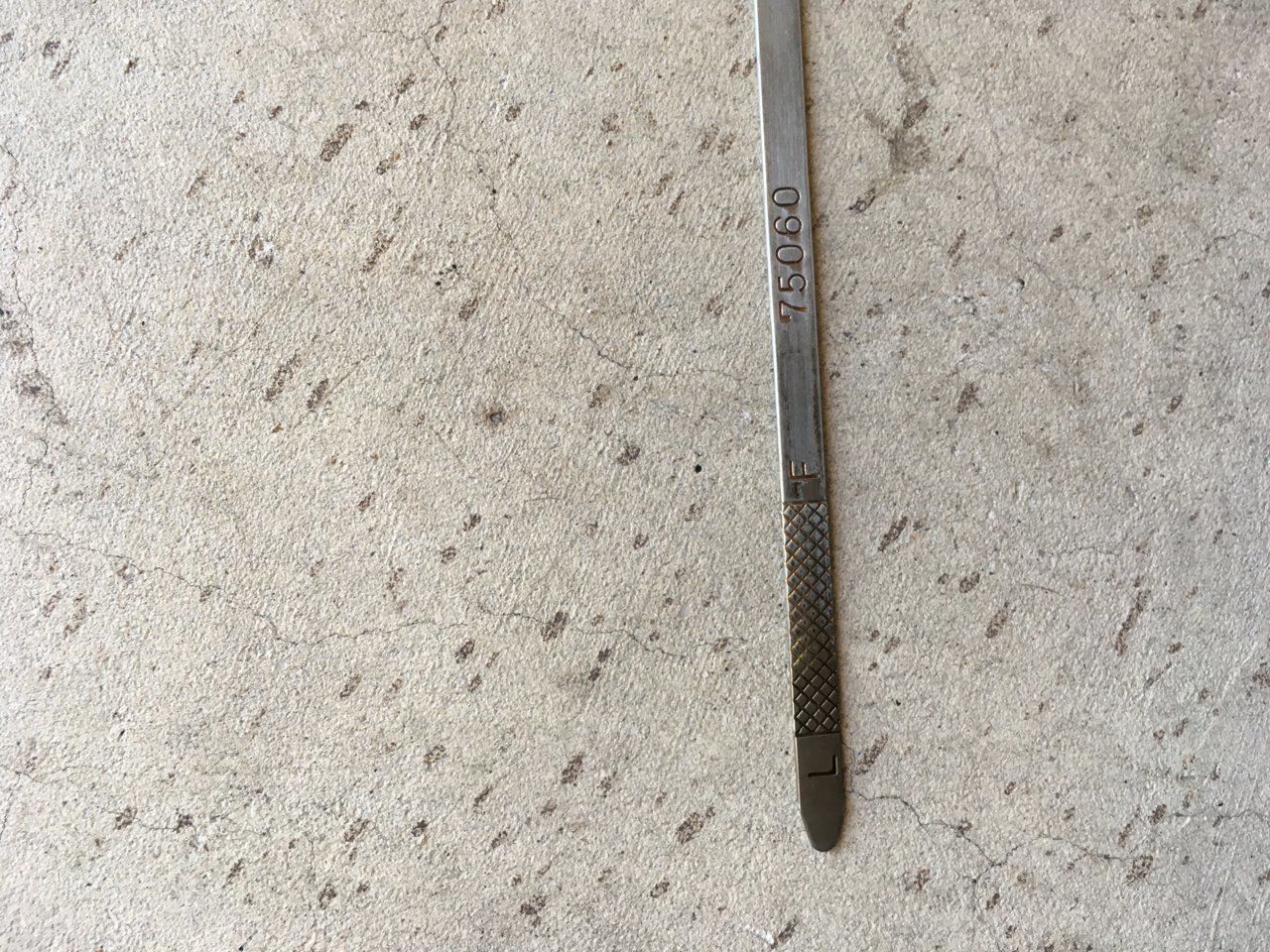

    After driving it about 5 miles and re-checking, it still is right at the full line with 5 quarts. Apparently I didn't get some drained out. Here's additional pics.
