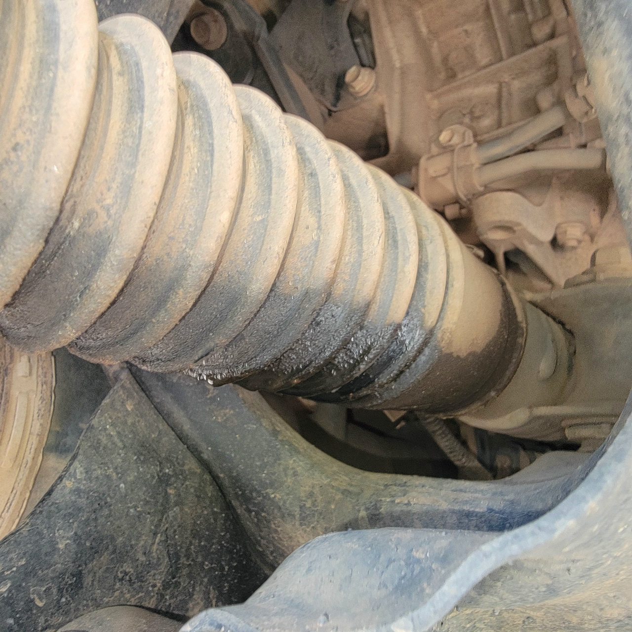

    Lots of Greece on the boot of the tie rod. It drives fine but should I have it replaced? 20230413_111633.jpg

    I'm Ghana say you should replace the boot before anything gets in there and messes up your rack

    Wheres it from? Could be leaking from the inside

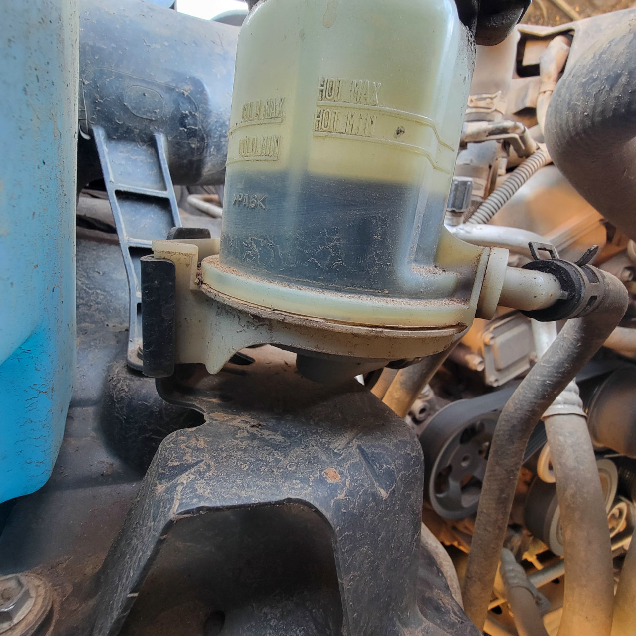

    To me that looks like the seals on the rack are leaking, unfortunately. Looks like it been that way a while too. Is the power steering reservoir running a bit low?

    Just checked and yeah looks like it.

    Looks like it needs to be replaced but I'm sure plenty of other things need replaced on your truck. It's always how much money you want to spend at that time. I'm sure it will be fine for awhile

    I Belize the fluid is leaking past the rack seal

    Iran into this same problem before. Leaking rack seal.

    Clean up the boots really well, top off the power steering fluid reservoir, then just drive as usual, and check it again in a month. If the boot isn’t too oily at that point, I’d suggest you just live with it and keep an eye on it, until it becomes more of a problem.
    My passenger side boot didn’t look quite as bad as yours when I bought the truck, but I did as I suggested above and found that it’s a very, very slow leak. No point in throwing money at that problem. I flushed the fluid and put a little bit of Lubegard into it, maybe that slowed it down further, maybe not. But in any case I consider it a non-issue for now.

    Thought I would update this just in case someone is searching for information in the future. I cleaned off the boot of all the grease at the time but then a month later I noticed it leaking again just a little bit. Once I turned the steering wheel to stretch out the boot there was a very small hole. I removed the boot and everything seemed fine so I just replaced the boot. Been driving on it a while and no more leaking and drives fine.

    The boot is just a dust cover, your rack and pinion is leaking. You would need to replace the rack if you want it to stop leaking.
