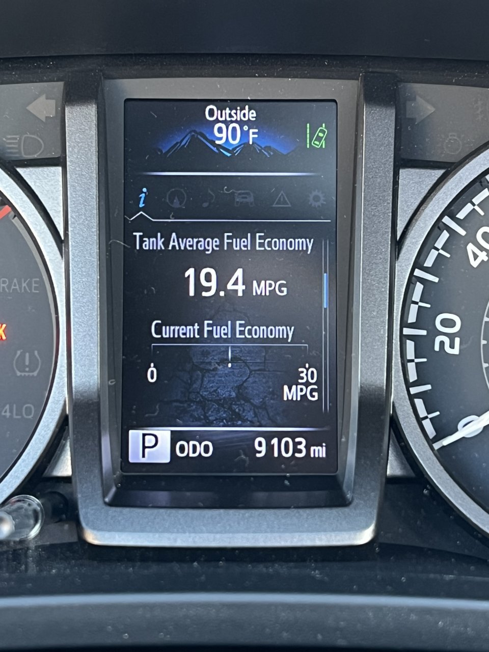

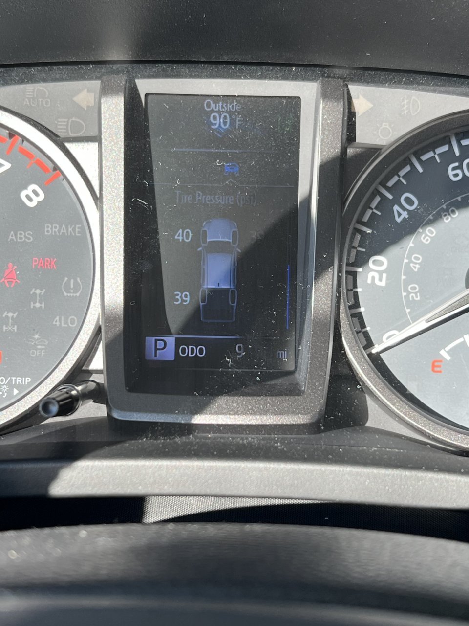

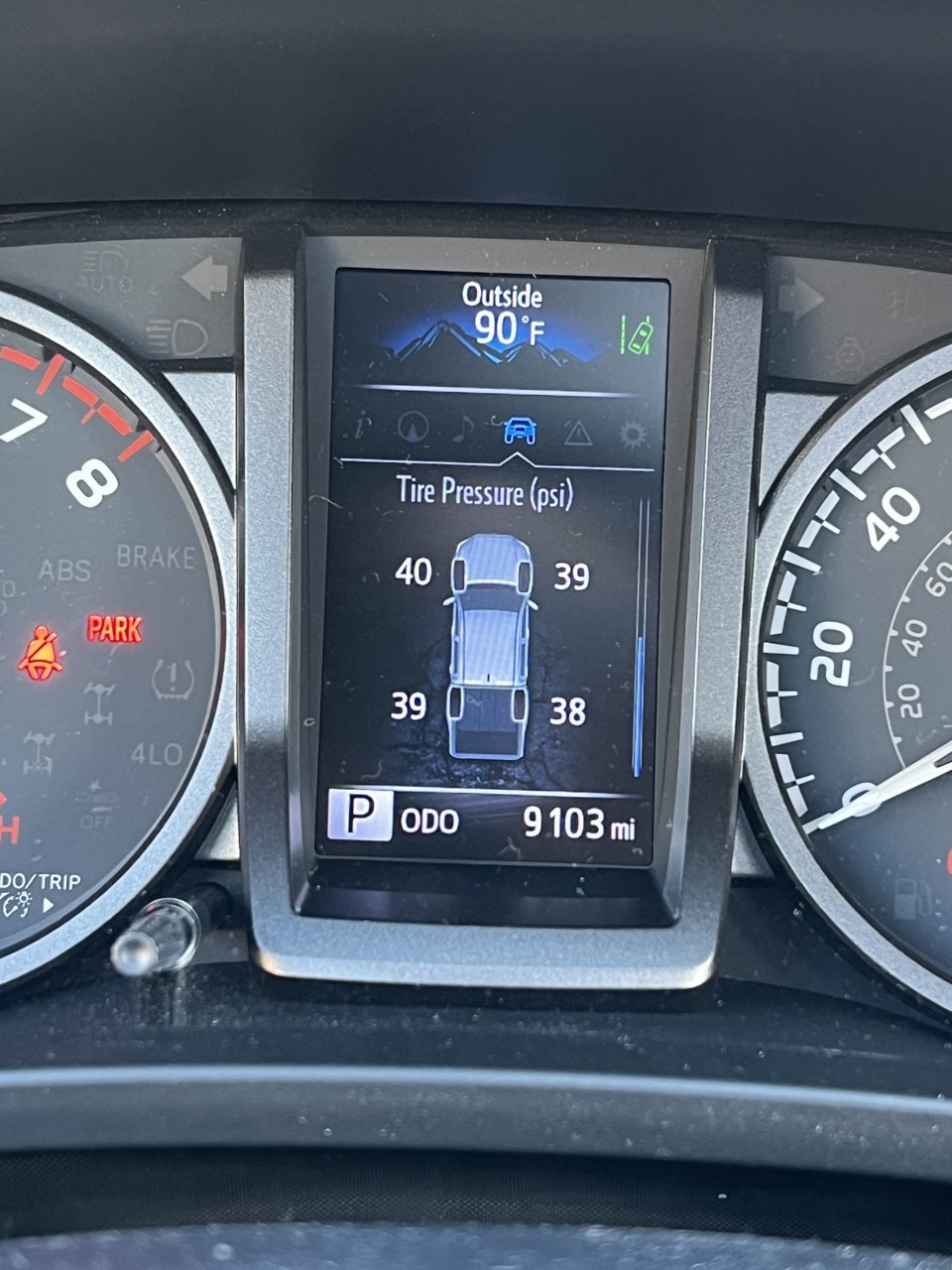

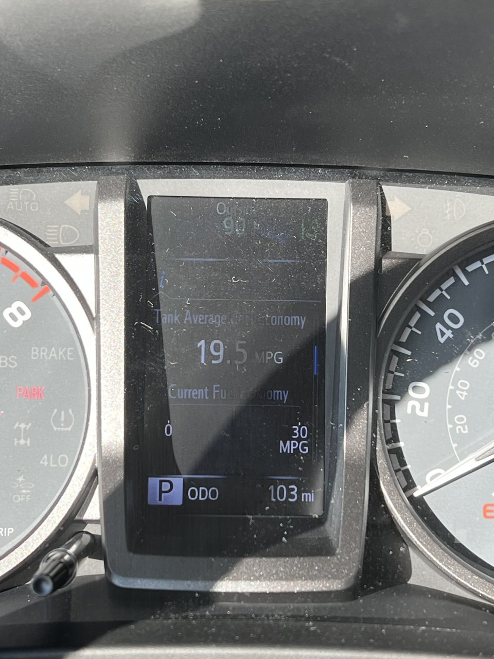

    Brought my truck to Les Schwab tire for the free air pressure check. Left with these numbers. Is it too much? Also seems like my mpg gotten better.

    Probably rides like wooden wagon wheels too eh.
    An overinflated tire can wear too. Really only way to tell is chalk test, since different sizes, tread style, build, etc etc can dictate that.

    Yes. Reduced footprint (traction safety), increased wear of center of tire, harsher ride.
    Maybe. Over inflation is certainly a basic tenant of hypermilers

    Yup, anything over 35psi is rough and causes tire wear issues on the factory tires.
    I usually set them to 34psi warm, so when the temps drop its still good.
    40psi is just a teenager reading the tire and setting it to max, or near max.

    Well of course you're getting better milage. You're riding on the very tippy-toe center of the tread.
    Not that the better milage is saving you money, after you factor the shortened life of your tires.
    I'd deflate those to a reasonable number. Like back to the 30-32 neighborhood. :D
