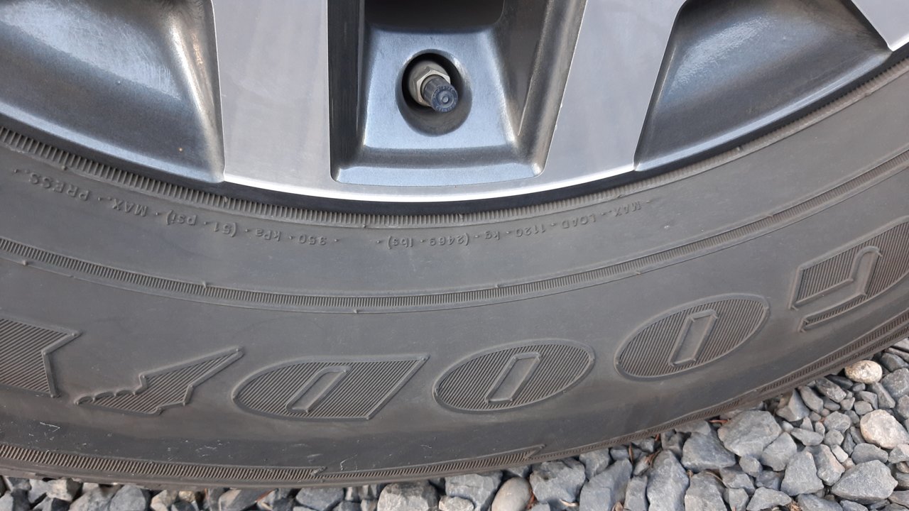

Is this too much air???

    Do the math man. Contact patch in square inches times four divided by max GVW. 32 is good all day long.

    Clearly not true. If it were, there would be no reason to have a MAX PSI.

    Max is just that, a max. Manufactures set pressures. The door placard is all that matters with OEM tires. Those tires could be installed on a number of vehicles with varying load ranges and specifications.

    So, tire can be used on Tacoma or a one ton full sized truck. Max psi is max psi with no regards to the vehicle. Tires do not care which vehicle they are on. Tires are not very smart. However, vehicles have different limits. Tacoma can go to around 6K, others, which might use the same tire, can go to 8K.
