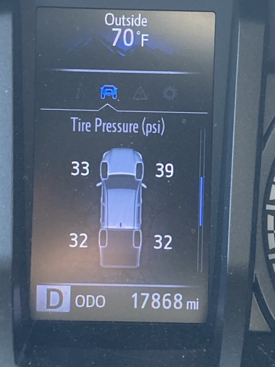

Is this too much air???

    OP, do you use summer air or winter air in your tires?

    The fact you're asking leads me to believe it's more than you're used to.
    You went there just for a pressure check?
    I'll assume you're on oem size/load rating Sport tires which are 29 psi cold.
    I'll also assume you posted your warm pressure after driving. Looks like Edgewood, WA was 81° high/69° low. So you should be at about 33 psi after a drive and at 81° ambient temp.
    Your increased mpg comes from a reduced longitudinal footprint.
    If you're on other than oem size and load rating, that changes things...

    You realize P-metric and euro-metric SL tires do not increase load capacity beyond 36 psi? Anything beyond 36 psi is meant to maintain the speed rating of the tire at very high speed.
    In a way, you are at "max".

    Not sure. It’s whatever tire les Schwab uses.

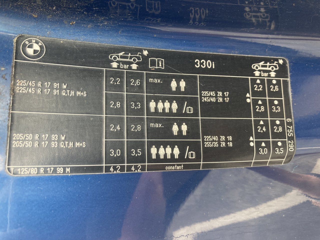

    Most cars in Europe List different pressure per load. This is off my old 2003 BMW convertible…

    I had an E46 ages ago but I do remember the funky tire pressure choices.
    I was wrong but was implying the tire pressures don't change how much the truck can carry.
    I read a chart awhile back that shows once these tacoma tires reach 32psi, there's very little gain in load rating. But I can't find that chart.
    https://www.toyotires.com/media/pxcjubjs/application_of_load_inflation_tables_20200723.pdf
    Here. It's interesting.
