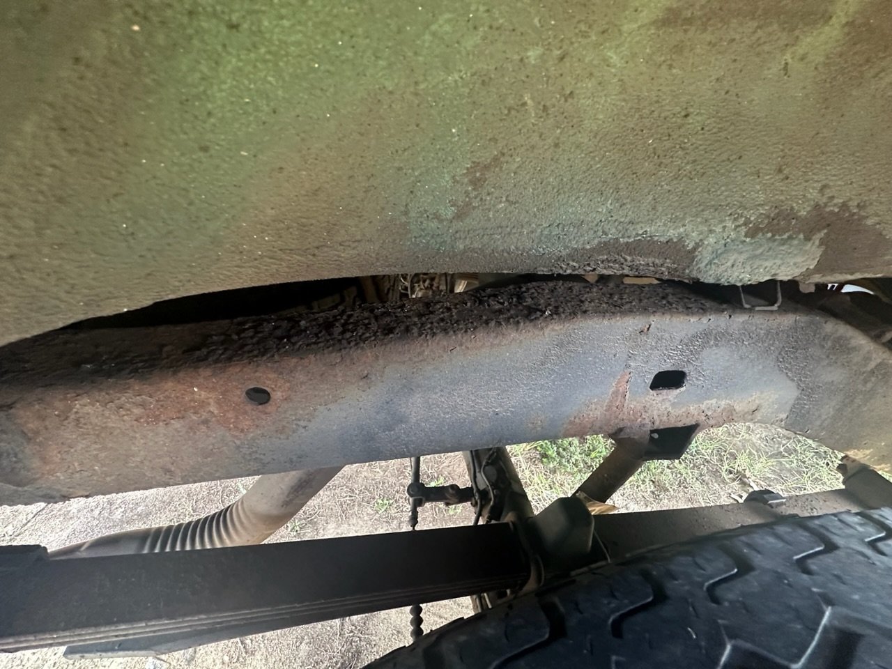

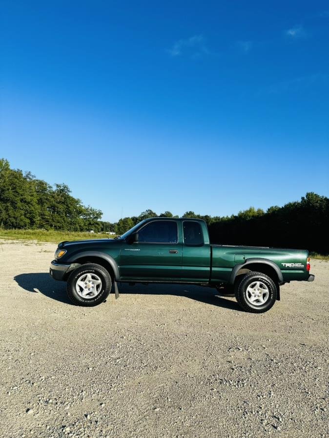

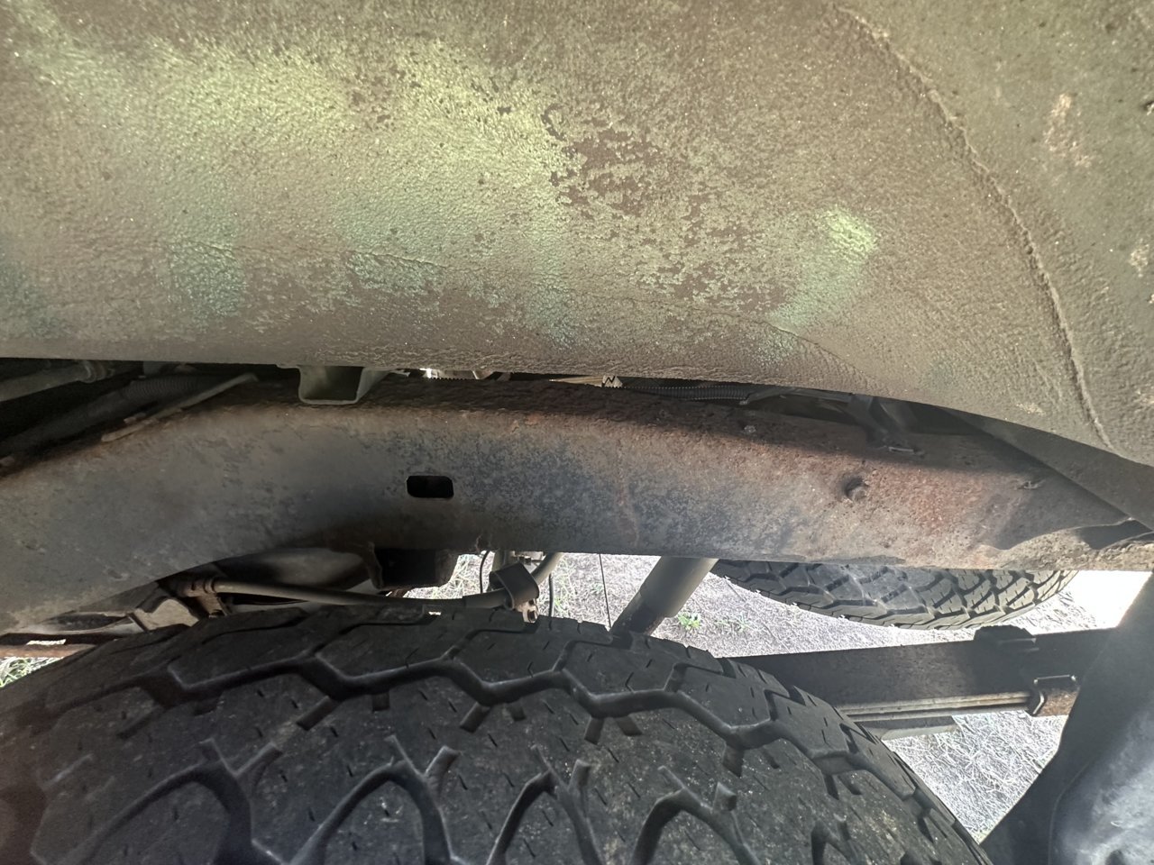

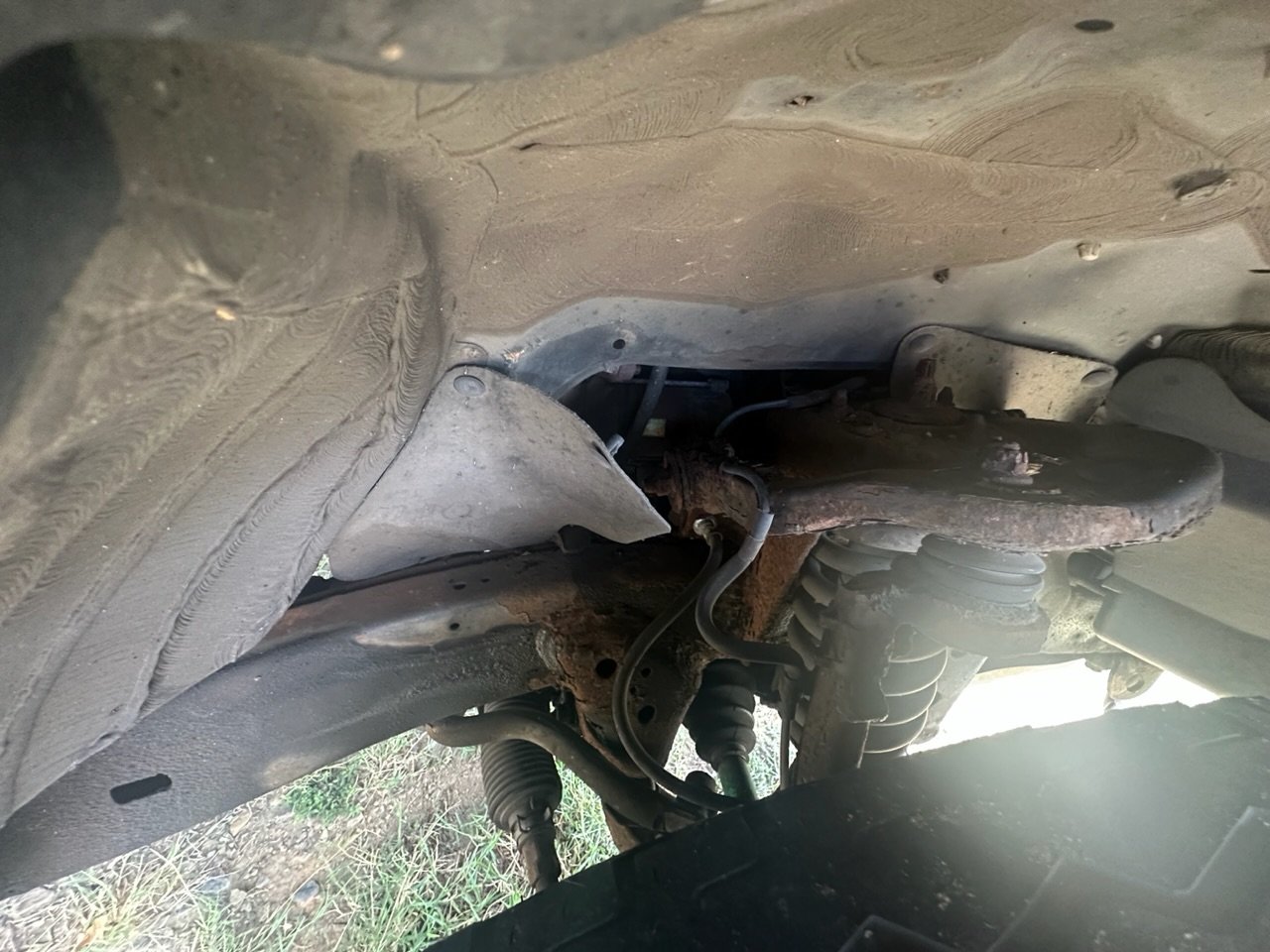

    Hey guys this is a 2003 extended cab v6 TRD with 143k. It spent its whole life in Maryland and has good maintenance records. It does have some rust. What do you think, is it worth buying? Can I put some rust coating on it and be ok or should I keep looking? It’s 13500 bucks, clean body, automatic.

    Looks like mostly surface/scale to me, but I wouldn't judge based on the picture the seller posted. He could be hiding real rust problems. You'd need to crawl under it to see everything

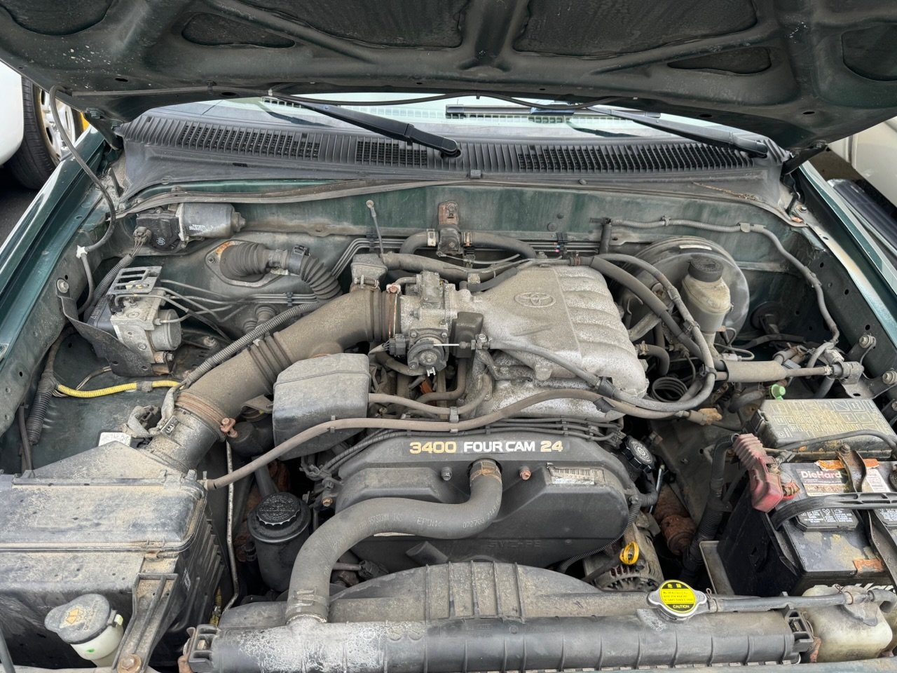

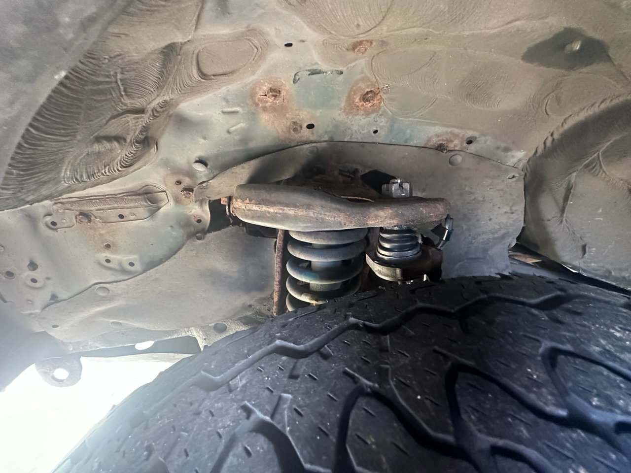

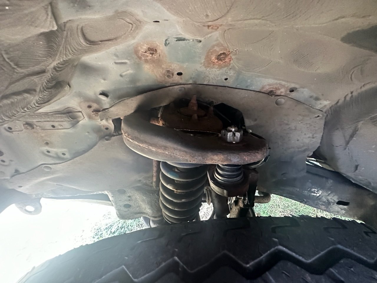

    Some things i see that i dont like, the frame approaching the fwd leaf spring perch (not in view) looks really bad, wont pass ping test, may even fail poke & plum test with long screwdriver. The left upper balljoint looks replaced (new nut & cotter pin) yet not the others? why do just one? huuuummmm. Is it me or are the plastic wheel well liners missing? it doesn’t look right, i realize the rubber dust curtains are all balled up but something is not right. The engine compartment represents total neglect, not hiding anything there, on a positive note, whoever did the timing belt reinstalled the proper constant pressure clamp....yay! The frame is on borrowed time stage IV, wouldn’t fly or drive to look at it, not for $13,500.

    Yea that price tag is ridiculous. If you're gonna fly somewhere for one of these, look in the Southwest. I'd rather have oxidized paint, than a rusted-through frame. Hard pass.

    Okay okay I see. Thanks for the info, I’m going to pass and keep looking. Thanks, yea only replacing one ball joint also seems weird.

    Anything from 01-04 you have to crawl under it and with a hammer and screw driver and test the frame front to back and inner and out sides of the frame rails.
