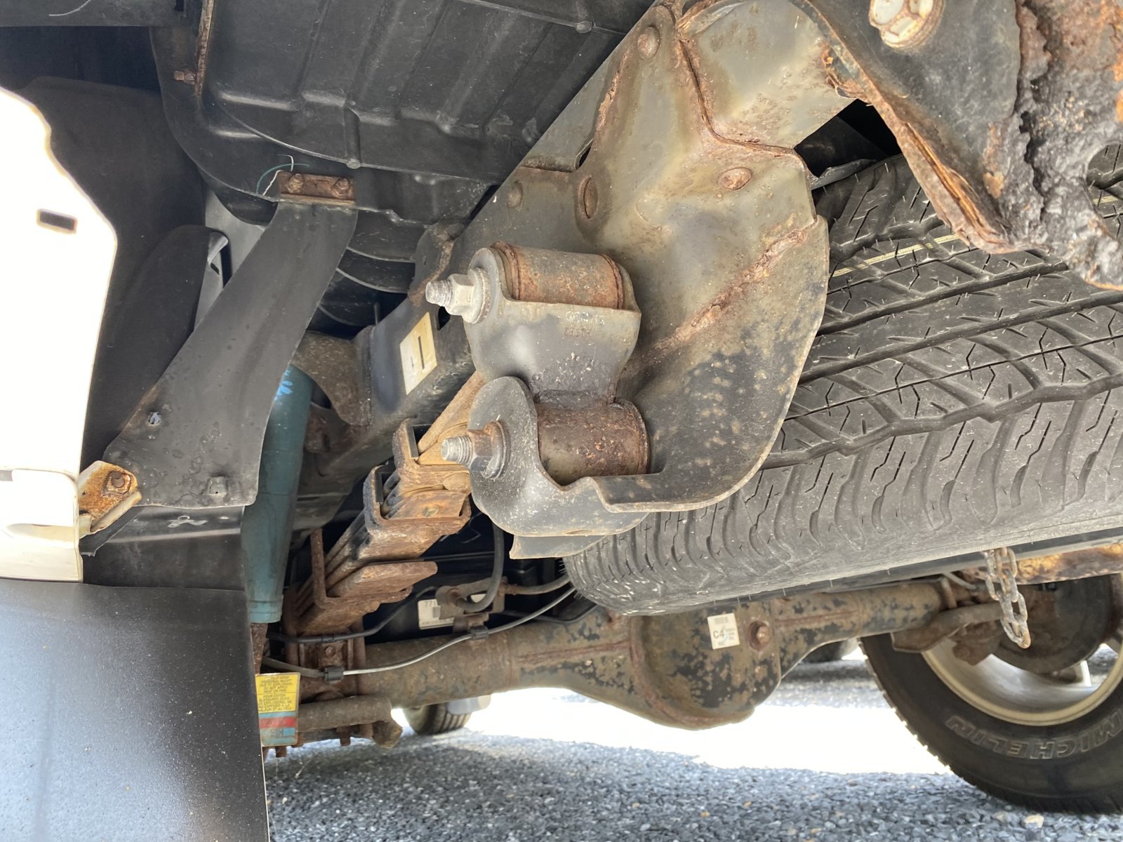

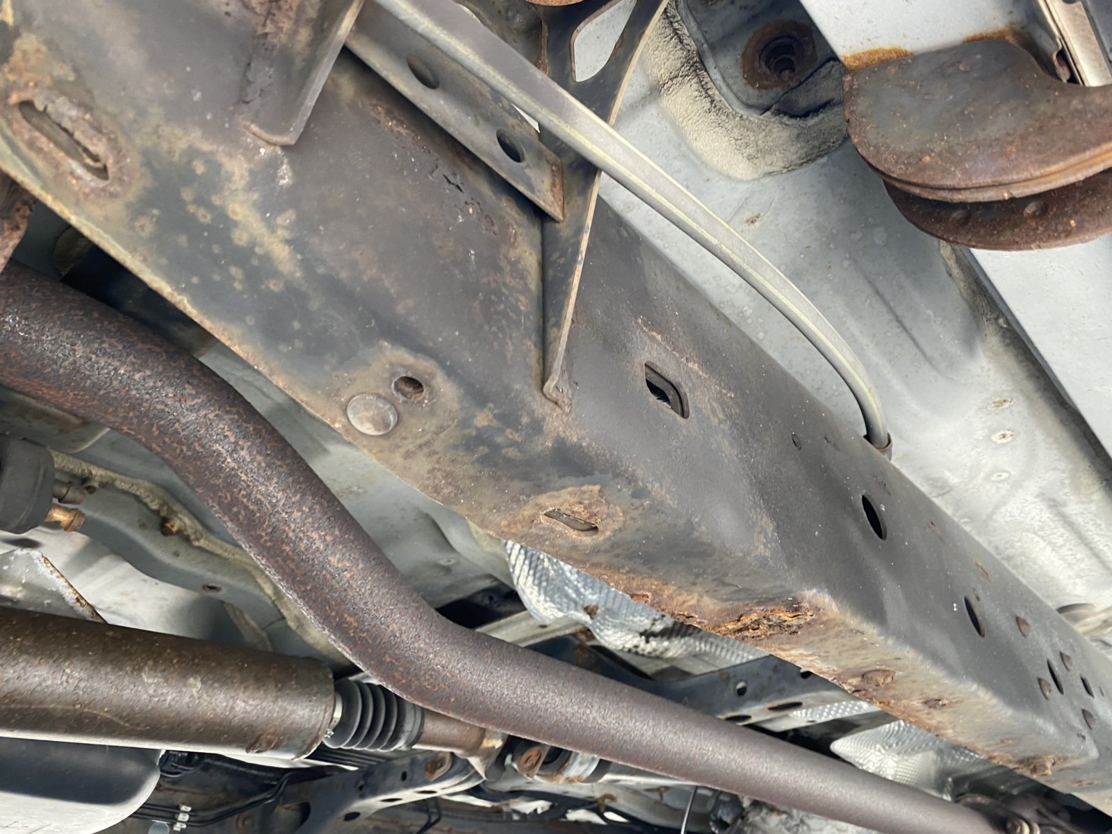

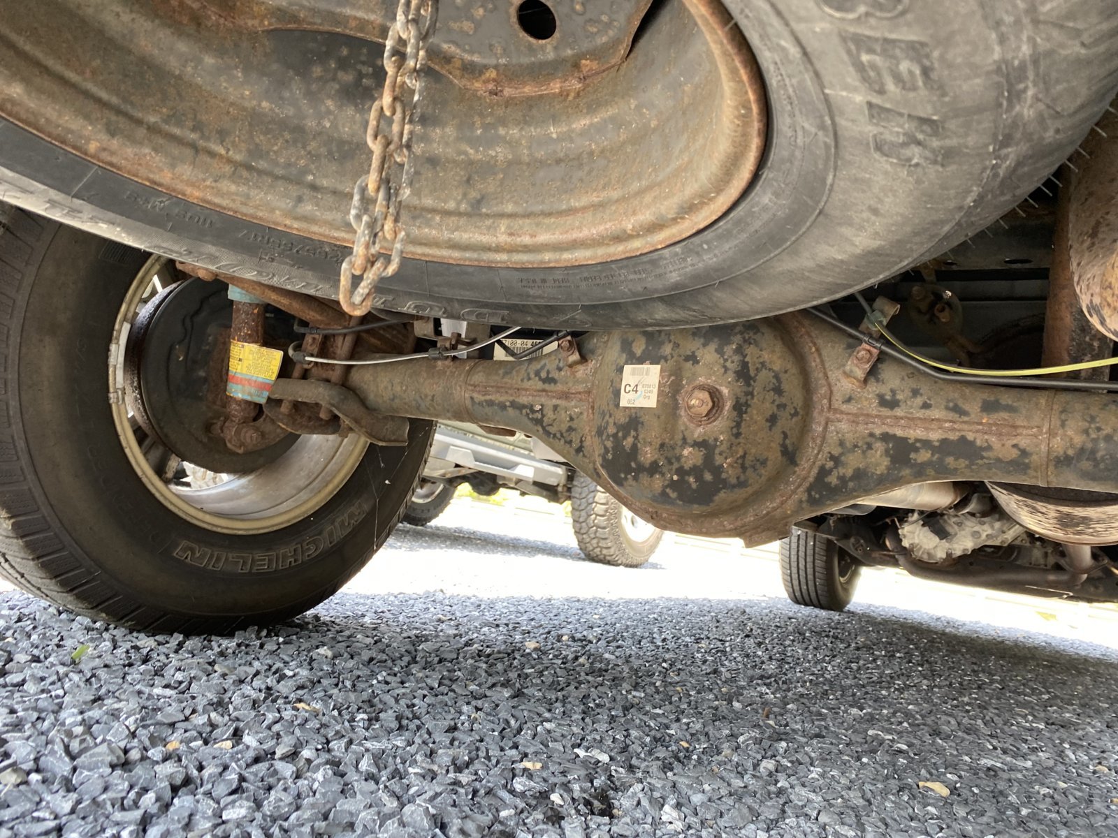

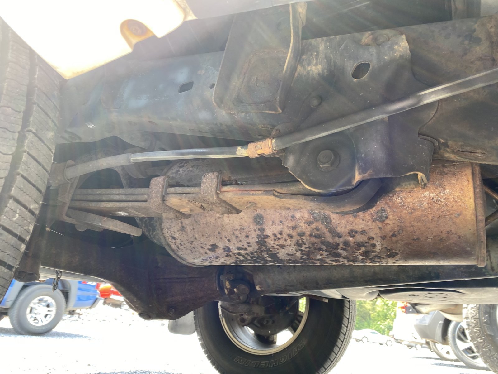

    I searched for a “too much rust” thread and didn’t find one…but I may be blind and if so I apologize for the duplicate. The newest 2nd gens are now almost 10 years old and some of them I’ve seen have rust also. Looking to buy a cleanish 2nd gen and I’m hoping you guys can help me out. This particular truck is a dclb sport that spent its life in Florida. By the rust, though not a ton, I’d guess it’s seen the beach a time or 2. It’s a 2013 with roughly 115k on it. Is this too much rust? First thing I’d do is clean it up and por15 everything. I’m looking for a truck that last me another 10+ years and 100k+ miles.

    You need to inspect the frame form under the truck looking out. (the inside portion)
    The key areas are beside the convertors. Drivers side is usually the worst.
    The cab mounts, the control arm mounting points. And rear frame on the passenger side, starting at the leaf spring mount going up and over the exhaust and muffler.
    The spot at the muffler is easily missed, and is the second most common area to rust. (First being the spot right next to the convertor on the drivers side.)
    Based on your pictures, I wouldn't be surprised if the frame is bad in those spots.

    Just went through this. If you aren't willing to travel, that might be a bit par for course for a salty state truck. The corner of the hitch looks pretty nasty in the first pic but I saw some pretty clean southern trucks that had super nasty hitches; so that may or may not be something to be scared of (unless you want to tow).

    This picture is a concern for me, looks like your rear bumper brackets are just about gone. Some of the other pics look like there might be some delamination starting around the boxed sections (bottom pic)

    Echoing what others above said. The hitch bracket in the first pic looks rough.
    Keeping in mind you can replace that. Also, like TnShooter said you really need to inspect the inside of the frame looking out
    That said after a quick look I dont see anything else thats alarming. Though you will want to keep an eye on where the steps mount to the rockers. Those will promote rust

    Again echoing what others said about the problem areas in the frame. That being said even if those spots are good, I'd still be passing unless it was a really good deal- with how rusty some of the hardware and various spots look I can see routine maintenance being a good deal more frustrating versus working on a cleaner truck.

    Does not look good at all. The truck may have been used to tow a boat and the rear shocks look like they've seen several salt water dunkings....Don't feel good about this one at all.
