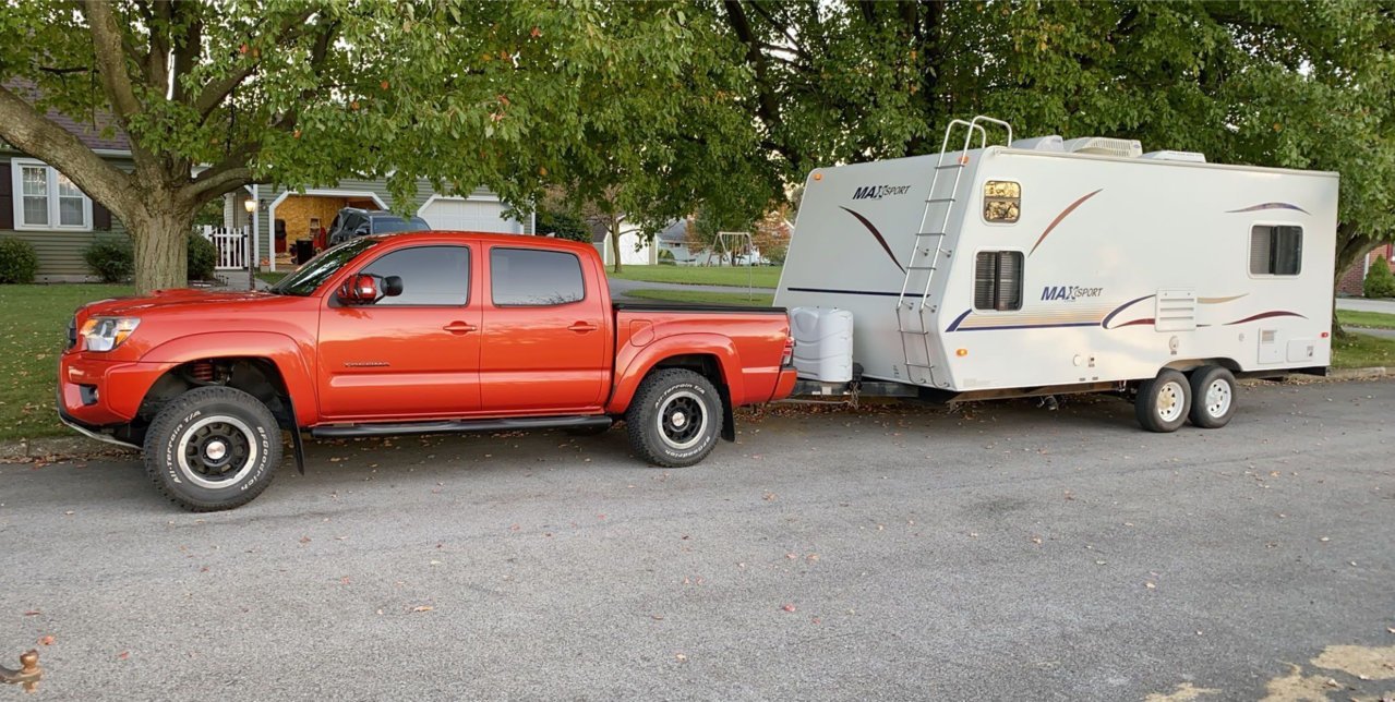

    The truck will PULL it just fine. The problem is that he is going to have to pack very carefully to not overload his trucks suspension. While the empty trailer weight is well within specs if he loads it to the max he is going to be just under 6000 lbs. His true tongue weight will be about 800 lbs. And then you need to add another 100 lbs for a weight distribution hitch putting about 900 lbs on the trucks suspension.
    The OP needs to look at the sticker on his door jamb to find his trucks payload. They are slightly different on all trucks, but mine is 1200 lbs. I weigh 220, my wife is 140. I would be over my payload with nothing in my truck but myself and my wife.
    Then you need to consider WHERE he is going to tow it. The tow ratings are calculated at sea level. The truck will lose about 3% of it's power for each 1000' above sea level and the max tow rating is reduced by the same amount. If he ever plans to go up to 5000' then the 6500 lb tow rating needs to be reduced by 15%, getting it to 5500. At 10,000' and there shouldn't be over 4500 lbs behind a Tacoma.
    In the real world about 4000-4500 lbs is a realistic limit for a Tacoma. This trailer will make that weight if packed carefully. But I'd not go any bigger. And would personally like something about 500-1000 lbs lighter.

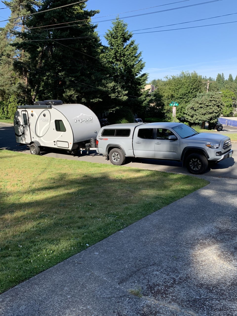

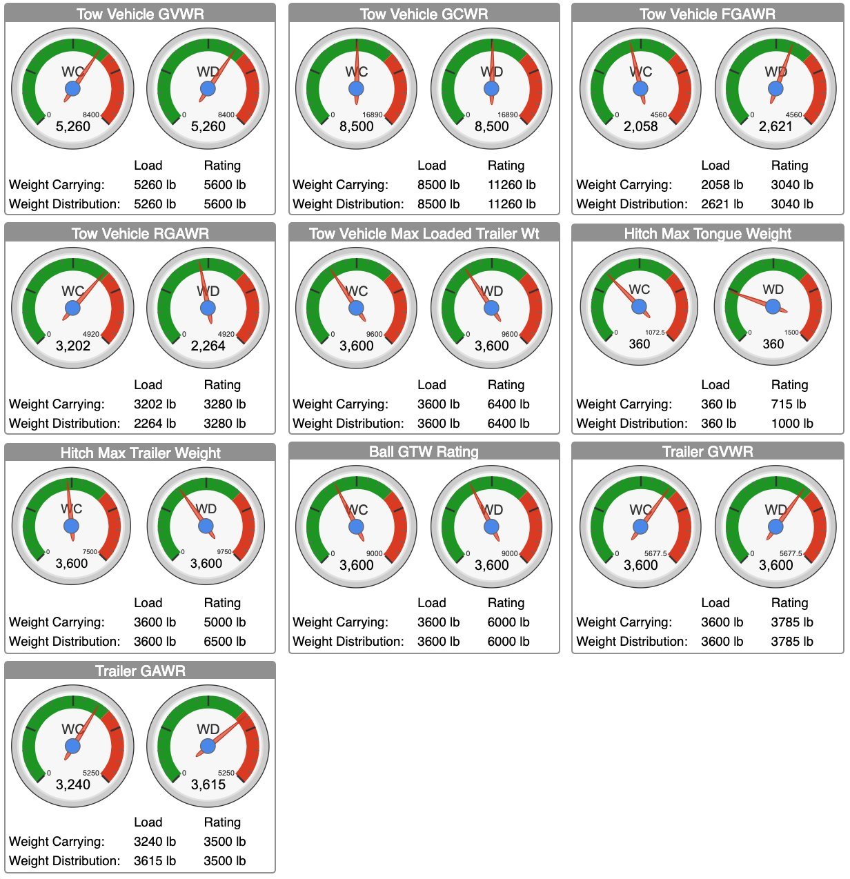

    I am towing an R-POD 179, very similar specs. Here’s my towing specs
    Towing hasn’t been fun. Of course, I’ve been towing in mountainous areas mainly.
    I started with a power brake booster and a weight distribution hitch. After my first major towing trip (2.5K miles) I installed the Terraflex Falcon suspension tow/haul setup...huge improvement. I recently installed 5:29 gears, but haven’t taken a significant trip while towing. I suspect, based on the short tows I have done, the new gears will make towing much better. I recently did 5K w/out my trailer and it was much better so I don’t see why this wouldn’t translate to towing as well.
    Based on the specs in the link, I think you would be in the red. You would be pushing the truck. I think you should take into account what type of region you are will be towing in, the distance you plan on towing, etc.. If you aren’t in extreme temp or hilly areas and don’t plan on towing too far, i wouldn’t think twice.
