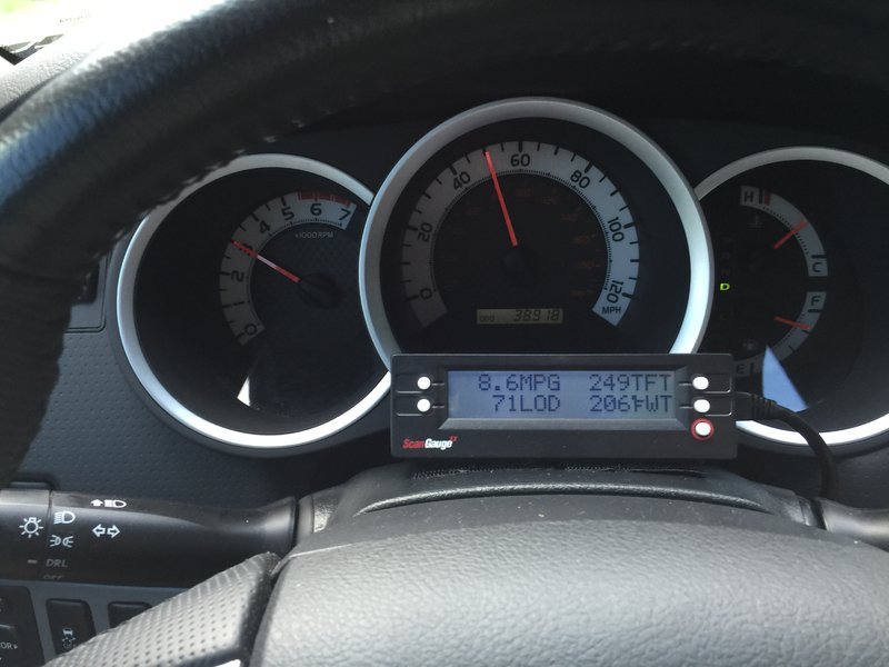

    This was my TFT when pulling a trailer during the hot summer last year going uphill. I figured this was about as tough as it would get. Ran just fine.

    should be towing in 4 not D, your trans will thank you

    This is a good general rule, but not always necessary. If the tranny is hunting for the right gear, definitely. If the load being towed is heavy and/ or you're going up steep inclines, yes. Light load and/ or flat terrain, driver can decide.

    Just saying if he was in 4 he would not be seeing 249 tranny temp. Anything over 220 is pretty bad IMO. It does state in the manual to use 4 only when towing.
