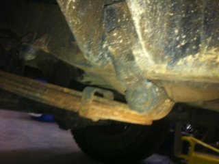

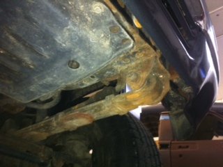

    Heres the front end.
    Looks like a ton of rust to me.

    Dana 44? I'm not sure maybe you guys know.

    That's not a ton of rust... my 2007 looked much worse than that when I traded it in last year :laugh:
    If you like off roading, having a second rig would be really nice over beating up your daily driver. The solid axle would be the big question mark in my book. Why would you spend the time and money dropping a solid axle in it, then keep it low and stock looking. I would wonder if it was either in an accident that wrecked the front end or it's had major body work to cover up off road damage.

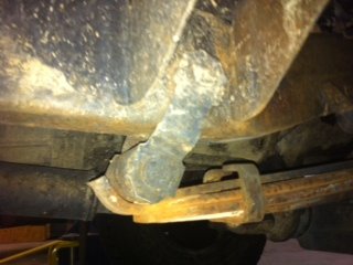

    Im not well educated on sas but does that shackle mount in the first pic seem odd?

    Looks like the leaf springs are shot, shock absorbers are probably also shot. It's not that hard of a fix I just did it to an 84 I bought. If you are mechanically inclined it's not hard could use that to drive down the price.
    I would be patient and keep looking.

    It's really low due to the leafs springs and shocks being done for. If you replace that it will go back up in height.

    Ok. here's my thoughts in locking at the pics. Without seeing the front end of the springs it looks like the SAS was done pretty well using stock parts. Those front shackles are stock height shackles and having the top of the shackle through the frame is the preferred method so that's good. The front axle is a stock Toyota front axle from a pre '85 truck. Most likely the axle is an '85 because the lower axle truss on the bottom of the axle looks to be the longer one. Hard to tell for sure.
    Here's a '85 front axle. You can see the lower truss runs out almost to the driverside knuckle.
    Here's an earlier axle with the shorter truss that ends before the ubolts.
    It's not a big deal which one is on the truck though. I'd be more curious about the steering setup. If it using the the older style steering with the J arm from the earlier trucks, I'd have that on the list of things to change and move to a real hysteer setup. Those old J arms are prone to breaking. My guess is that is what is on the truck since the tie rod is under the springs and you can't see the drag link. A hysteer setup will be like the pics I posted and the tierod and draglink will both be above the axle.
    Looks like it's using stock Toyota leaf springs that are worn out. That explains why it's basically at stock ride height. The rust all looks like surface rust to me and could easily be cleaned up so I wouldn't be worried about it.
    If I hadn't just bought my new land cruiser I'd be all over buying this thing. I think the price seems fair too. These were available with the 22RE 4cyl or the 3VZ V6. There is not a big difference in power and the V6 was notorious for bad head gaskets so the 22RE is the better motor for sure IMO.
    Again, for the OP, if I were you I'd buy it for sure.
