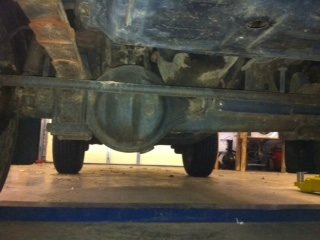

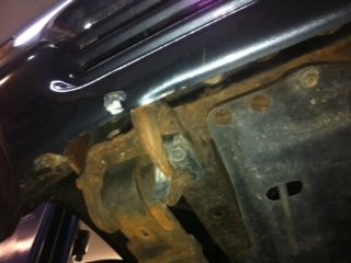

    It has a 20r head on a 22re. Not to sold on this. Any thoughts?
  13. Jan 28, 2015 at 8:59 AM
    #53
    thefatkid
    thefatkid Well-Known Member
    Apr 5, 2013
    #101370
    4,358
    Brian
    Colorado
    2004 thingy
    If you look at the frame pics, the truck is running the old 79-85 push pull steering. It also has the factory 79-85 skid plate.
    This truck looks like a body swap on an older frame.
  14. Jan 28, 2015 at 9:01 AM
    #54
    thefatkid
    Apr 5, 2013
    #101370
    4,358
    Brian
    Colorado
    2004 thingy
    If you look in these 2 pics you see the factory torque link. By the 2nd pic it looks like the frame is the later 84-85 frame, I would need to see behind the bumper to know for sure.
