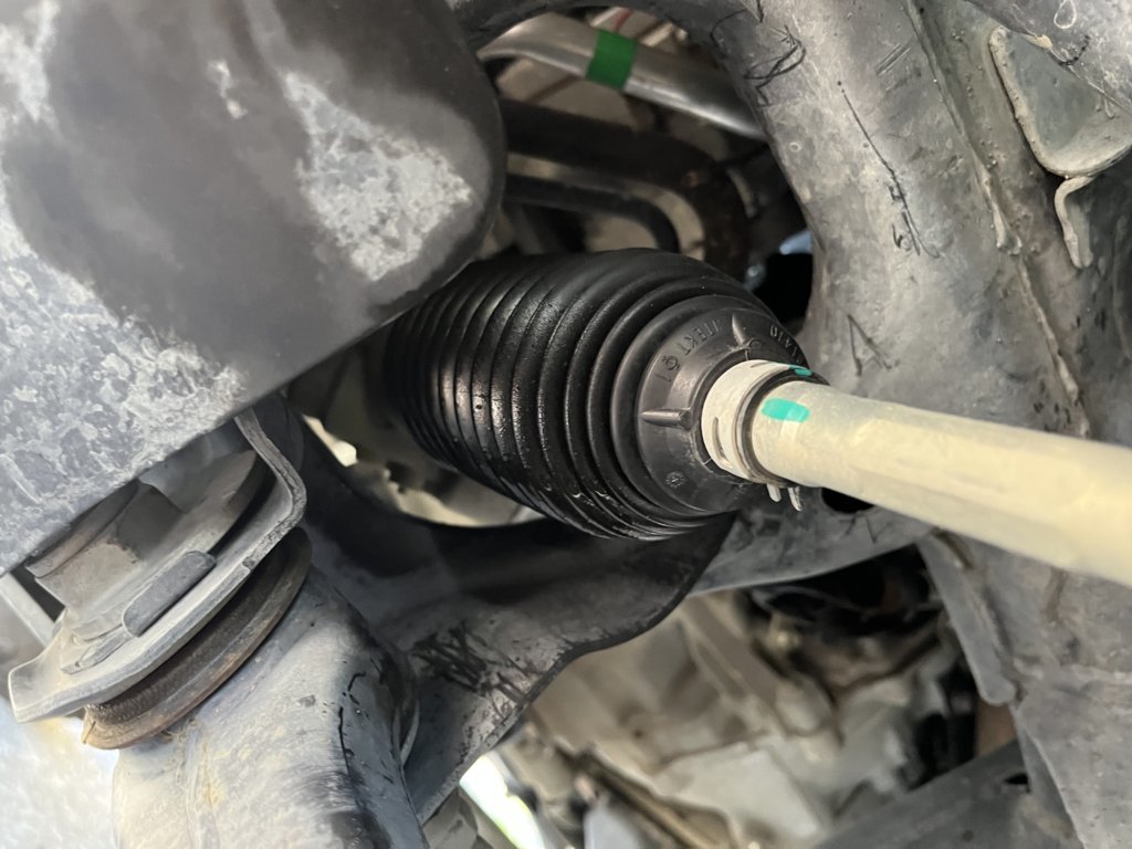

    I have seen plenty of stock Toyotas at 150k with leaky racks. We replace them often at work.

    I've never seen a lifted or stock 3rd gen with a NON leaky rack lol. Boots are wet on literally every Tacoma I've looked at. Just the way of the road...mine have been wet for like 50k miles now.
