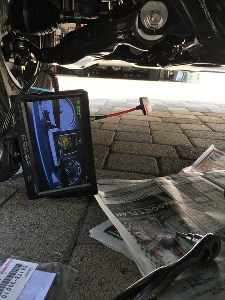

    Thought I would share my experience, just washed the ATF off my hands :) My truck is an OR 4x4 w/ tow package built 5/10 in Mexico. I have 250 miles or so on it and noticed the transmission being a little hesitant and clunky so wanted to check for piece of mind. I added 1qt of new Toyota WS fluid to start with. I then pinned the thermostat open and cycled through R and D a couple times to distribute fluid while I waited for it to come up to temp. The system ended up taking around 1/3qt of fluid.
    Used one of my racing drones sitting on the steering wheel to help keep an eye on the temp light while under the truck :)
