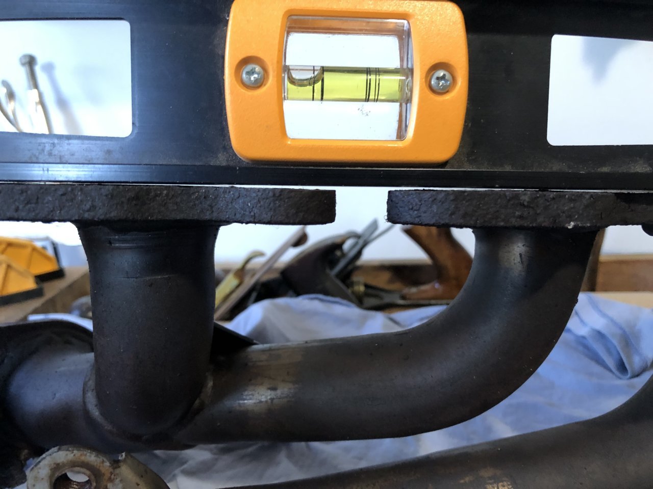

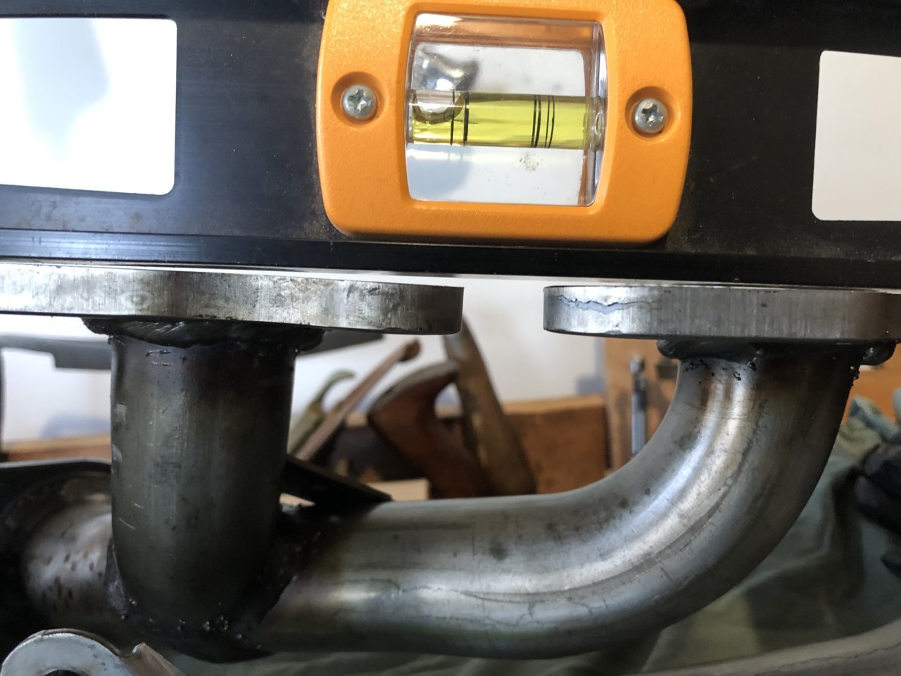

  14. Feb 2, 2023 at 4:53 AM
    #54
    RoscoeTT
    RoscoeTT [OP] Well-Known Member
    Jul 12, 2021
    #371133
    160
    New York
    2002 Toyota Tacoma
