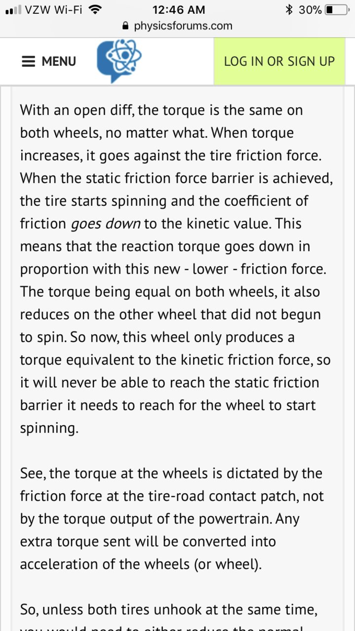

    DaveInDenver and Pigpen like this.

    Good explanation

    It doesn’t matter what terms you use to describe the phenomenon. The fact is that with an open diff, when one wheel is in the air, the other wheel does not have the power to move the vehicle.
    It seems everyone has agreed on this, and now it’s just a matter of who is using the correct theory to describe why it happens. :crazy:

    Yes, of course if the wheel isn't rotating the amount of torque is just equal to the friction on the wheel and is balanced down to very little. An open diff allows the wheels to spin at different velocities, so yeah, torque isn't the right way to explain it I guess. A simple open differential takes the input speed and makes the average speed of the two outputs the same. In a partially zero traction situation that means one may be zero RPM (with traction) and the other tries to match the input (neglecting drive ratios for the sake of argument) by spinning fast against no traction.
    So differentials balance the torque across the axle. Thinking of it as percentages and sending power is wrong for simple differentials (perhaps not for active torque vectoring). A differential can never send more torque than what is available, which works out to be twice the tractive force present at the wheel with the lower coefficient of friction. IOW, 100% of the engine's torque is at most split 50/50 ideally if both tires experience the exact same conditions. But in a reduced traction situation the torque split is still, just that less than 100% of the engine's torque is transferred based since less friction is present on one wheel compared to the other.
    In the twisted axle scenario with a wheel in the air the amount of torque on the grounded wheel is based on the moment and inertia of the one spinning uncontrolledly fast in the air. It's not zero but it's also not enough to propel the truck forward. The differential's intrinsic characteristic is the maximum torque is a function of the minimum friction (or rotational velocity anyway).
    To solve this you put torque sensing diffs, limited slip clutches, automatic lockers, manual lockers, spools, etc. in there. On the road this corrects for the weight shift as you turn, off road it prevents the wheel with no traction from balancing the differential to almost zero torque. None of them change the mechanics here. I do admit to being nonchalant and technically lazy.
