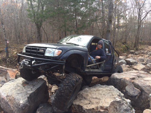

    Yep, never wheeled before. Must have no idea what holds up and what doesn’t.

    ^^^^^^ Great pic! Awesome ride!
