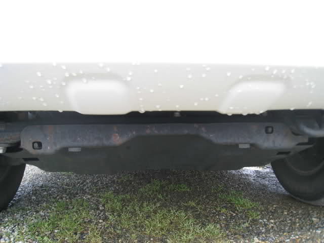

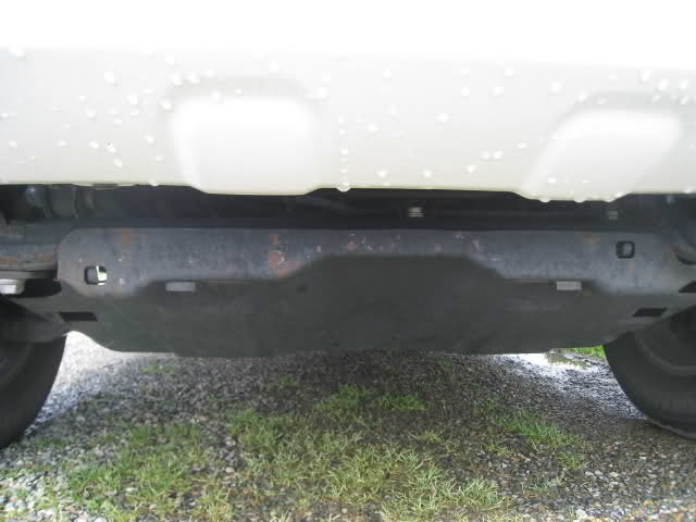

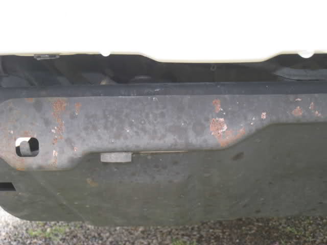

    My truck is an 05 and I'm seeing rust here and there. Is this normal?

    I'm in Colorado, and that amount of rust seems pretty normal. I don't think the paint they used on a lot of the underside is so great.
    Most of my rust is not from rotting away, but rocks chip at the crap paint and expose metal. We all know what happens to exposed metal...
    I have similar rust on the front of my frame and certain parts under the truck. Sand it, paint it, keep your eye on it.

    Yes I bought it used at 14k and I'm the second owner. The previous owner lived in Washington as well. Maybe its because lack of care I rarely wash underneath the truck.

    thats nothing. look at your frame if you want to get sad real quick.

    Trust me, as soon as these trucks see salt and road grime they will start to rust. I have rock chips on my door that are rusting, my powder coated bumper is starting to show, and every spring/early summer I crawl under my truck and grind and re-spray bedliner on everything that is showing rust.
    Ohh yeah, I have an 09... Just one of the joys of living in Alberta, Canada

    Holy fuck , that's an 05 ? My truck looked like that sitting new on the lot when I bought it

    I'm starting to feel I have nothing to worry about since its minimal.

    My 09 looks far worst then your 05. I wouldn't worry at all op

    Get some POR 15. You can paint right over the rust. It actually sticks to surface rust better as long as there's no flaking. It's not cheap, but it goes a long way and it works.

    Back on the topic from the OP, I wouldn't worry about that little bit of rust on the skid plate. They are cheap metal anyways and the best thing to do is pull it off and put on something that will actually protect.
