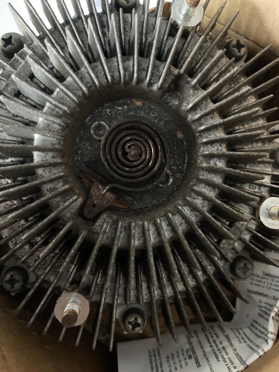

    Cooling fan is loud. Is this normal for Tacomas? Everybody who’s sat in my truck says it’s loud. Every acceleration video I’ve seen doesn’t have this noise. I just replaced the fan clutch with a new aftermarket today with only minimal improvement. Not sure to keep trying to trace this issue or to give up and ride it as is.
    video is my tacoma accelerating. Above 3k you hear a distinct howling. Noise never goes away. Can be 5 minutes of driving or an hour of driving.

    I thought the fan clutch was seized(bi-metallic was very rusty and didn’t move) and forced the fan to constantly be engaged. Turns out it’s not the case.
    The only other thing I can think of is a bad idler pulley, but I’ve only heard of a whine not a howling noise like it’s sucking air in. At this point i rather trade it in then throw more parts at it lol.

    New aftermarket Hayden fan clutch has been in for a week. Truck is much quieter now. Just needed to be broken in. The OEM bi-metallic switch was indeed seized.
    The old clutch would never disengage at 5000rpm, the new clutch does. There is still a faint fan roar but I can say it’s anywhere from 30% to 70% less noise now. And engine is more responsive/shifts smoother. I guess the fan was putting noticeable load on the motor
