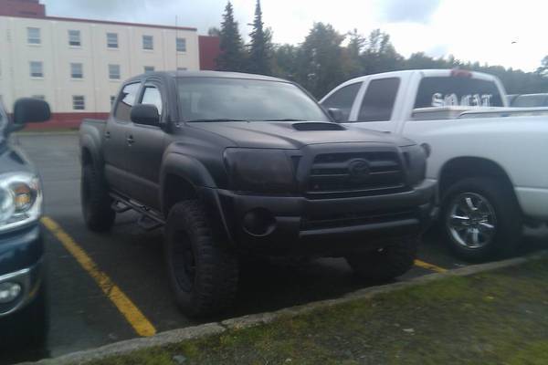

    Nice build man, never thought I'de like a gold taco.

    Old picture taken in July or so, but here's mine, i love it. Painted. Difficult at times to maintain, but worth it.

    1,682
    :eek::eek: That is puuuuurrrdyyy
