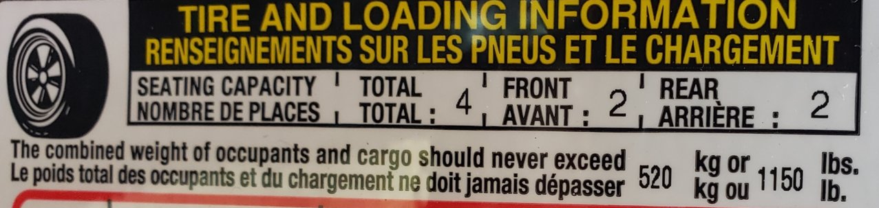

    Looks like you’re close or maybe even over, but the sticker in your door jamb has the GVWR for your specific truck, they’re all a little different depending on trim and options.

    What you've listed is all payload weight. What does your door jamb sticker say?

    BTW: unless it’s in Jerry cans, fuel isn’t “payload.” So your calculated weight is 1170 lb, versus whatever your door jamb label says. If it is 1150, you are in rounding error territory…nothing wrong with using the truck at its limit.
    BTW: a full tank of gas is 80 L, which is only 132 pounds…but I assume your other guesstimates are closer.
