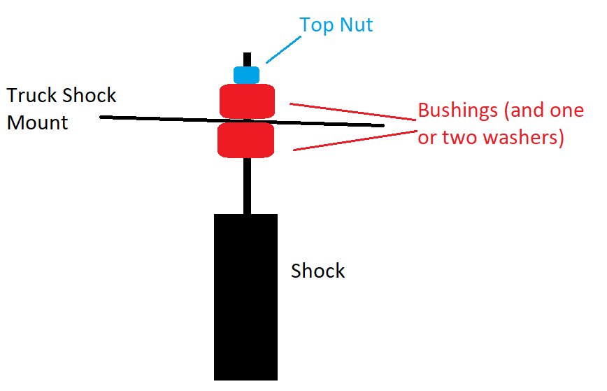

    OP, hope you figure it out. In the mean time, take those boots off the shocks. They just hold water and your shocks will rust.
    Do you have all the proper bushings installed on the shocks? Should be some rubber and metal on the top mount of the shock.

    I think he's missing a bushing which would cause the .5-1" discrepancy.
    Top shock mount should look like this:
    mynameissean123[OP] likes this.

    That would explain why the two shocks don't look the same, but wouldn't explain the different measurement since the shocks don't determine ride height
    zippsub9 likes this.
