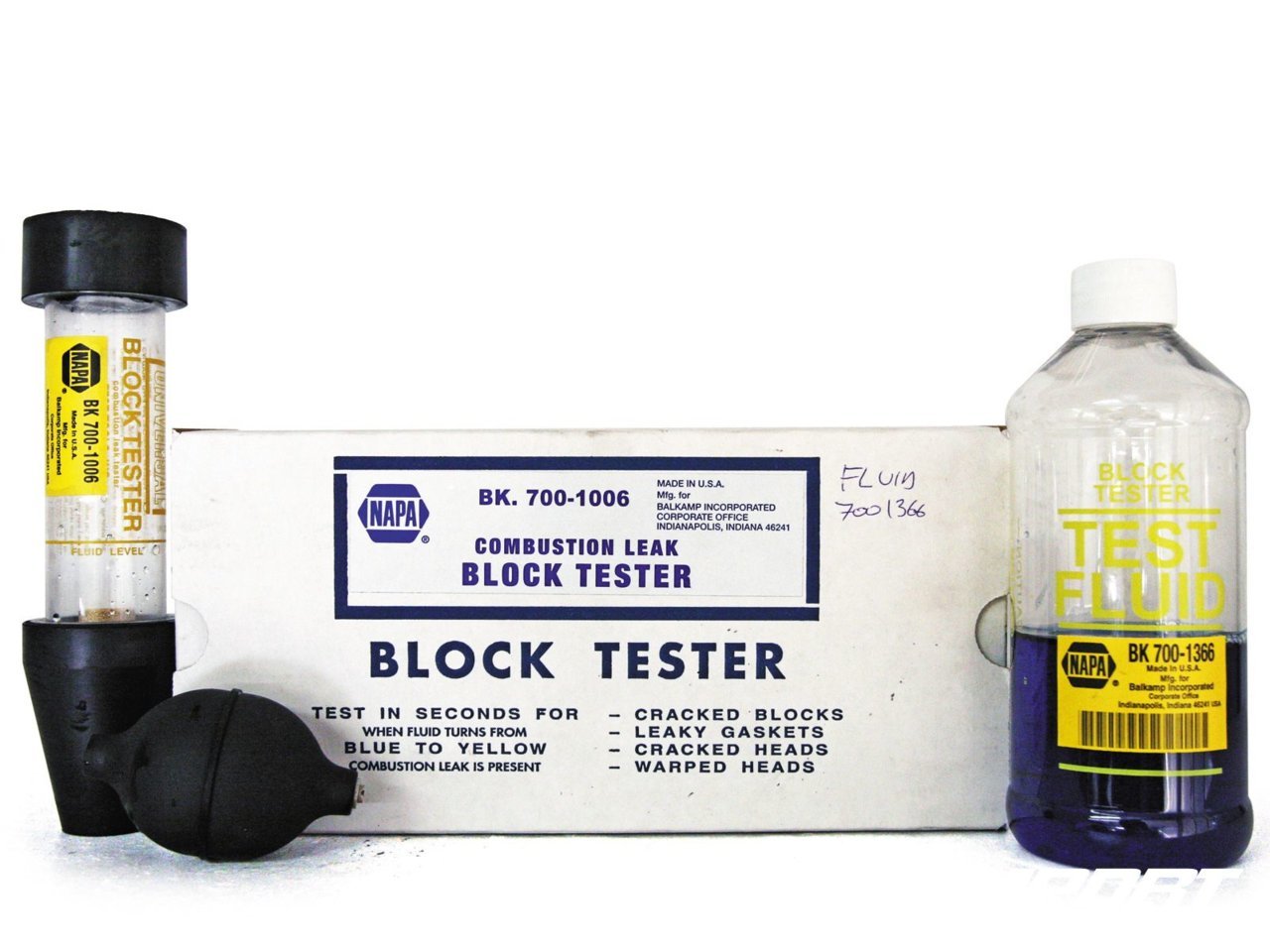

    Leak? Radiator cap? Coolant compression test would be a good idea

    That is hot. Mine got around that temp when my headgasket blew.
    Test for gasses in coolant.
    Check oil for coolant.
    Your system is sucking air in from somewhere and the air doesn't let the coolant flow.

    What would be the best test to check if the head gasket is fried? I don’t have any coolant in oil, car starts and idles fine every single time.

    Because it is an extremely widely known fact that the 05-06’ had a defective head gasket design. We are trying to save you from wasting time and money chasing other stupid stuff. All you have to do is go to a shop and they will test the coolant for exhaust gas, if it is there your head gasket is blown plain and simple. If not THEN spend money chasing all the small shit.
