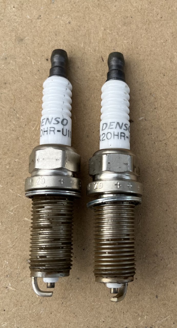

    Unfortunately I already threw the boxes away, and today was trash day so they’re long gone. But here’s a pic of two bad plugs. One is definitely cracked

    Hard to tell. They look legit. I'd say you have 2 cracked ones. Other one just isn't visibly obvious. Get 2 more and call it good.
