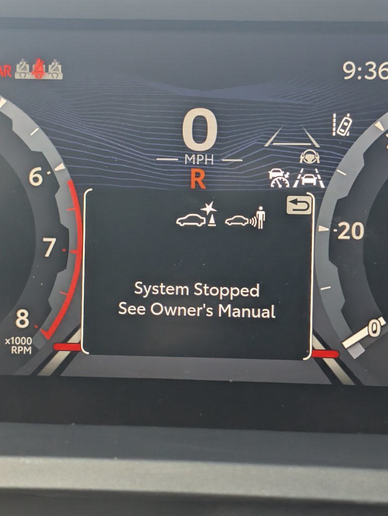

    I have the same issue, they ordered a part (didn't say what( but it's taken months and it's finally here, getting installed on Monday. My car alarm randomly goes off too due to the issue. It's really annoying. Today I saw a new trouble indicator on the dash which I believe is connected sensors for people/objects ect

    I just took mines in for the same problem, when the light comes on the alarms goes off and the reverse camera and sensors dont work.
    The answer they gave me was the latch was adjusted and the sensor was tighten or something and its all fixed as they say, came back on later about 2hrs later. Need to take it back to check it again. However I have a camper on so hopefully not the camper issues.

    Havent noticed any alarms but I have had notifed my safety sensors & parking guides turned off
