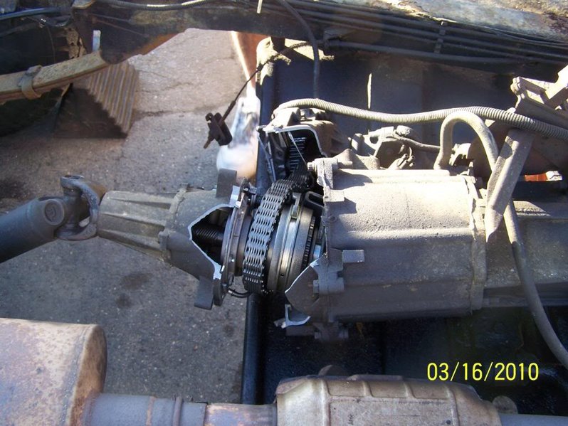

    image.jpg Note, paragraph from Doug007's link:
    When traveling with part time 4WD on high traction surfaces like asphalt, concrete, etc. handling of the vehicle will become unsafe (understeer) and the "driveline binding" will eventually cause component failures. Part time 4WD should not be used on high traction surfaces! Even when going straight most of the time, slight differences in tire pressure front to rear or vehicle load resulting in different axle speeds will cause "wind up" and eventually damage.
