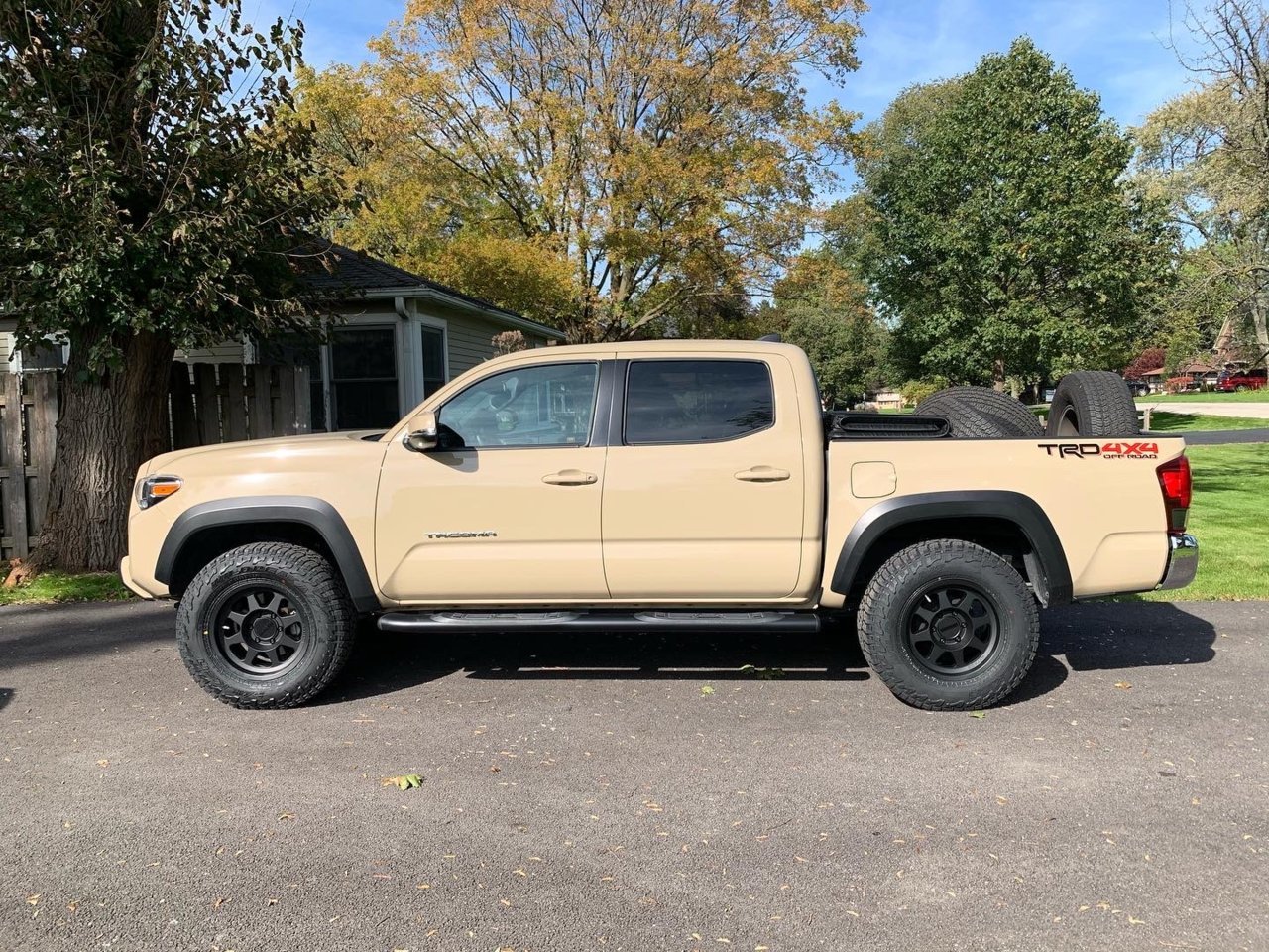

    I just put new wheels and tires on the truck, and I purchased new censors from Discount Tire when I did so. Truck looks great but the tire pressure is not reading. I've hit the reset button but its not registering. Am I missing something? Did they not actually install them?
    Thanks for the help. Heres a pic of the truck though, it looks great!

    Those wheels look great - nice choice. I recently had a set of tires installed and the shop broke 2 of my sensors removing the old ones from the rim. They replaced them and mated them up to the truck, but it took nearly a week for them to start showing a number again. You need to drive at least 25 minutes continuously for them to register. My commute to work is short and I'm not on the highway a lot, which is why it took so long for mine.
