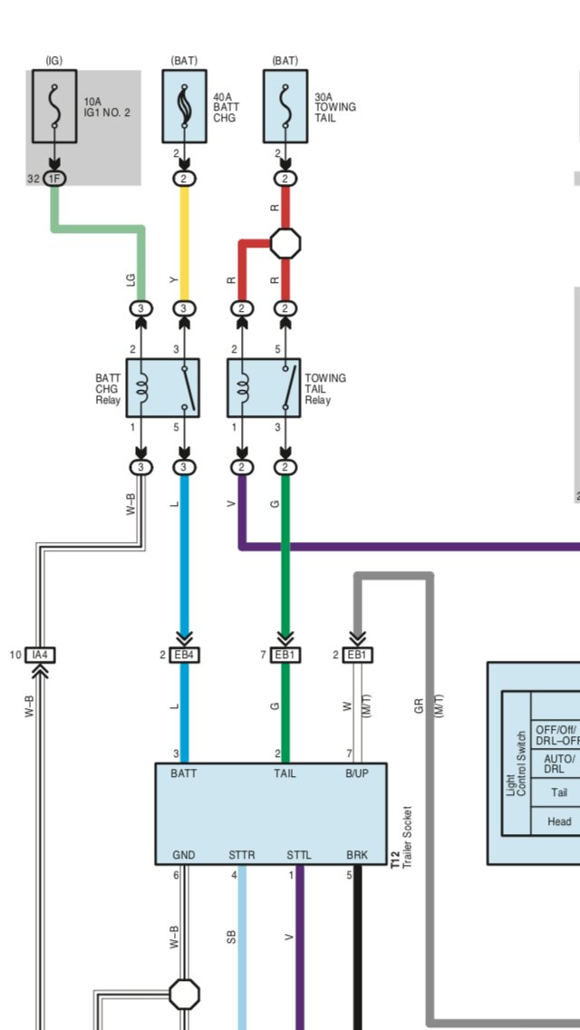

    I have been trying to get the tail ( pin 5 brown wire)lights on my boat trailer to work. All other lights work (break,LT & RT,) I used electrical tester to check all other lights and I got 12 volts. Pin 5 on the receiver should have 12volts but have Zero. Any ideas?

    Sounds like the wire is broken somewhere before the trailer connector.

    Check the towing tail fuse and relay. The trucks tail lights are working right?

    Yes truck tail lights work.

    Since the trucks lights work, if it’s not the fuse or relay then probably a bad/loose connection or a broken wire.
