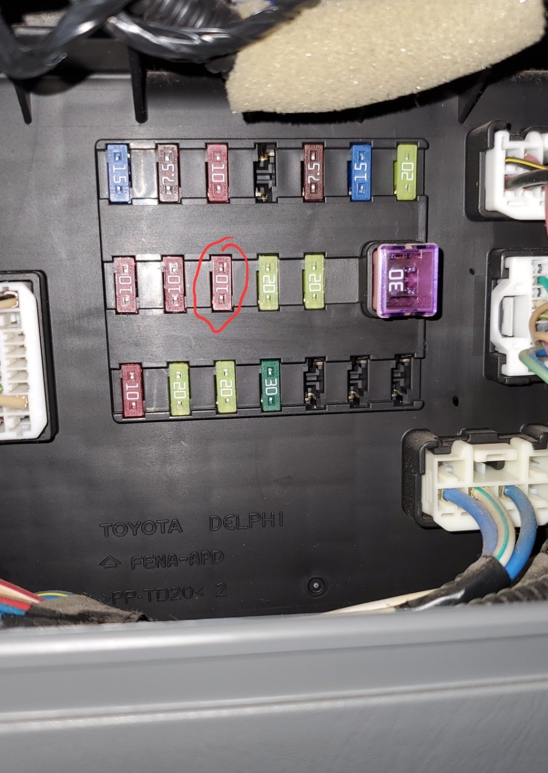

    I have a 2010 Toyota Tacoma. I put in a new subwoofer and amp today and ran into some issues. Suddenly the turn signals and AC didn’t work, but my flashers do. I tried switching it to the heater to see if hot air would blow out and it stayed the same. Then the truck didn’t want to shift out of park, this was after I drove around for a while. I checked a few fuses, but I’m not sure what other fuses to check. I tried both IGN fuses in the drivers side box and no luck. I have a little scanner after the check engine light turned on and it showed P0705 Any ideas what this could be?
    Thanks!
    -Victor

    Sounds like your IG1 Fuse is blown, it powers all of those things.

    I tried replacing that fuse and still nothing :/

    Do you have a test light so you can check for power at the fuse?

    Yes, all of them passed. However I was thinking if it could be a relay.

    15a acc fuse behind the coin holder, maybe. Good luck.

    So you have power on both sides of the IG1 fuse in the interior fuse box?

    I Just checked!!! It worked! Thank you so much saved me a hassle!
