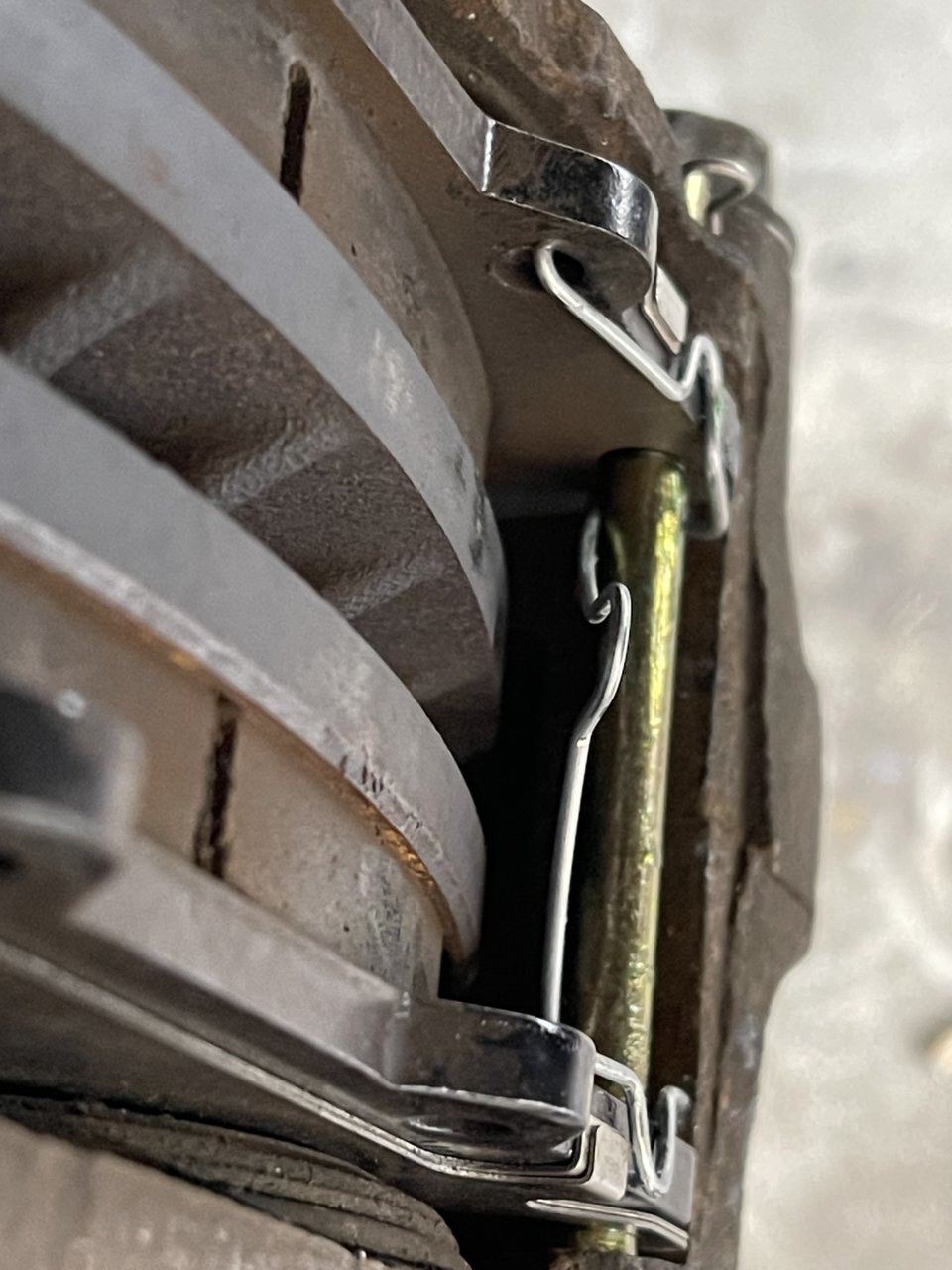

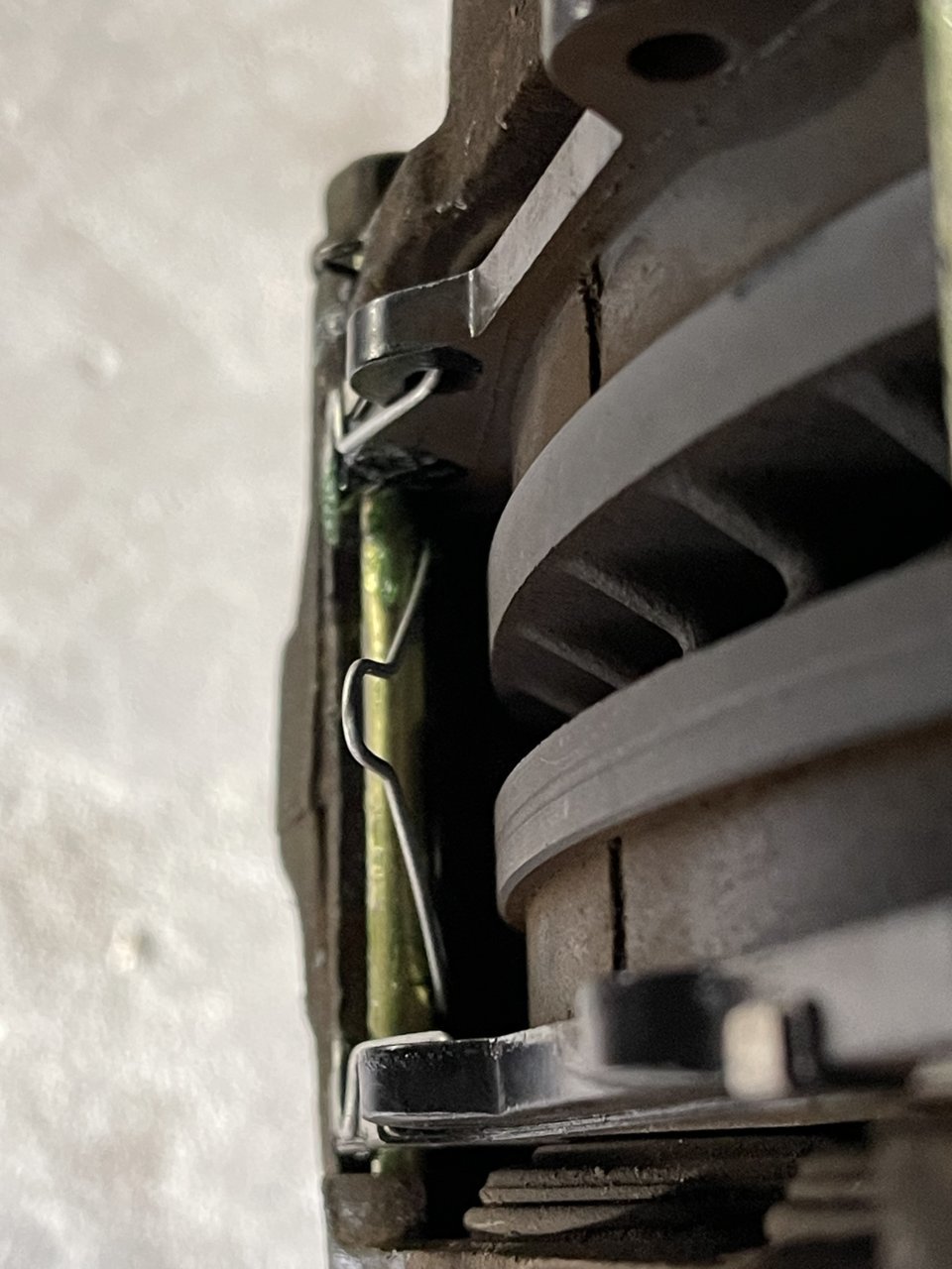

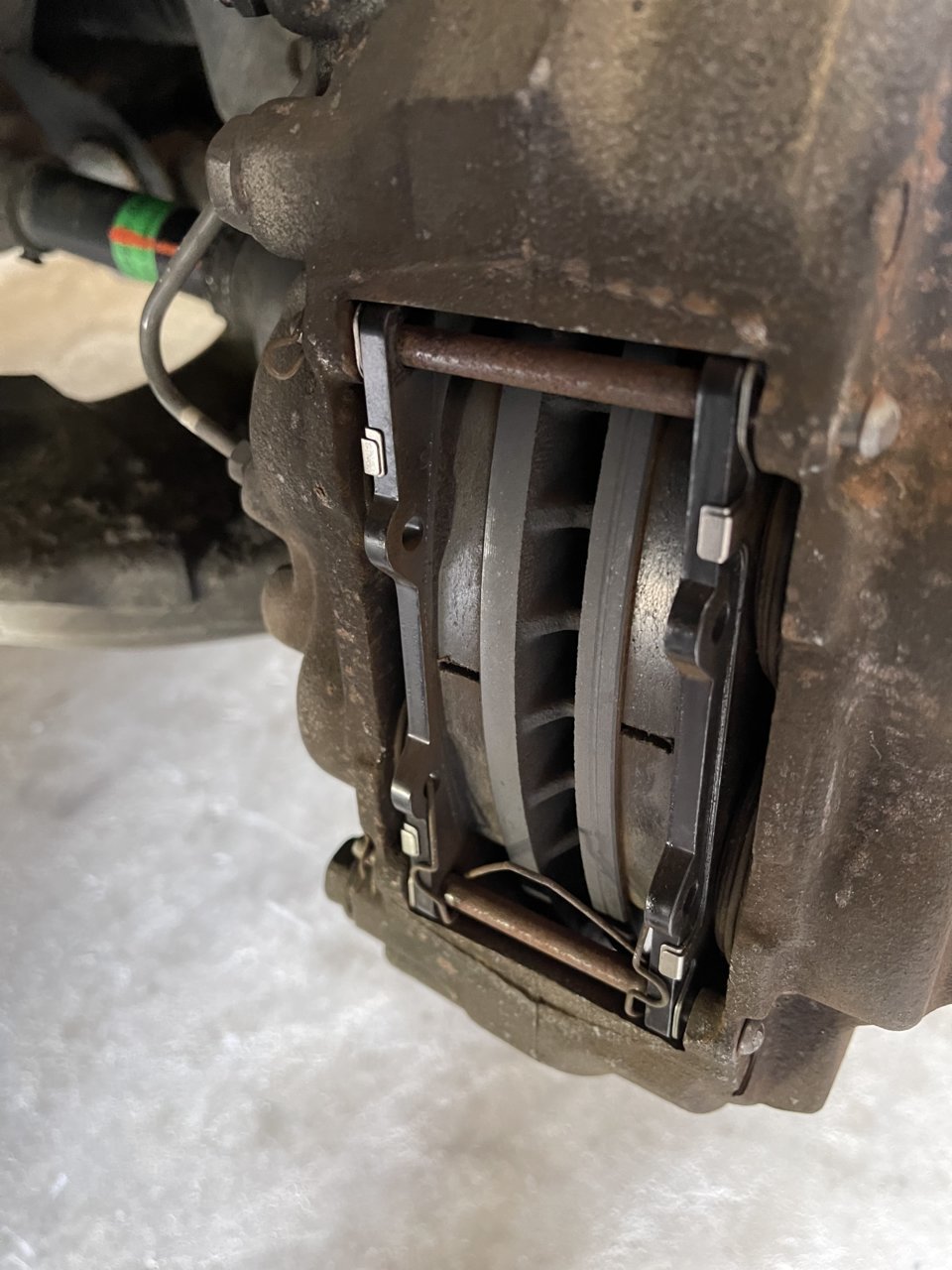

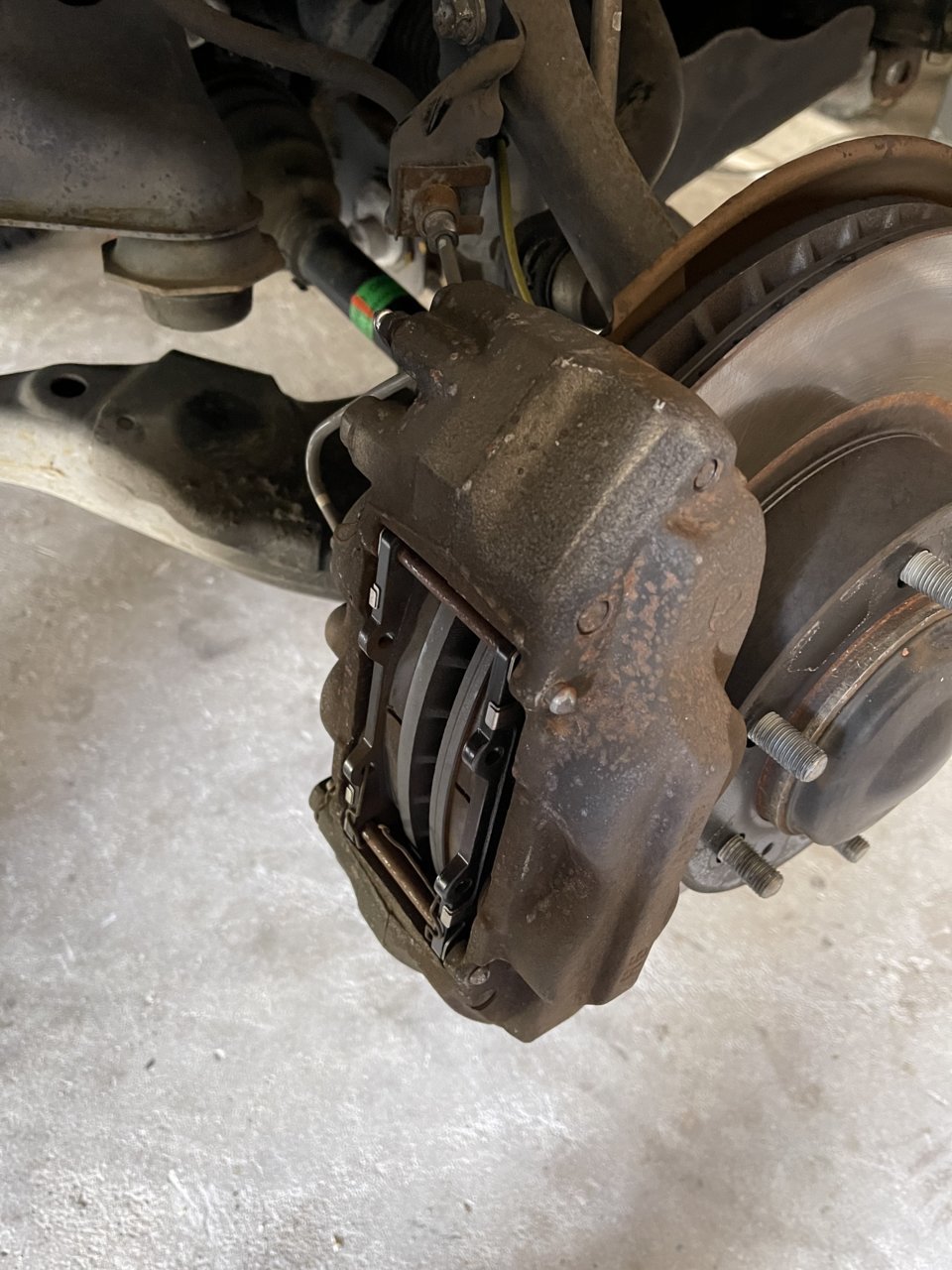

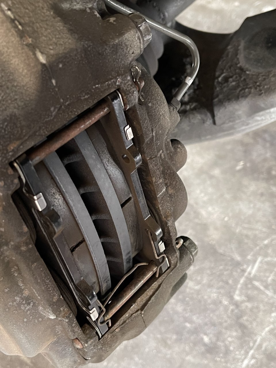

    A month later, the front brakes started screeching, really bad (loud). Two weeks of enduring that screeching noise, I decided to schedule another appointment, but first, I found this forum and viewed some YouTube videos and gathered enough courage to jack up my Taco, remove the front driver wheel and take a look for myself. This is what I found:
    Those pad pins don't look lubricated to me (above), like some videos on YouTube that I've watched (the contact points where the parts meet/move). The upper pin is secured by a safety clip (below). The pin moves freely from side to side, but I don't see any evidence of lubrication anywhere. Rust is everywhere however.

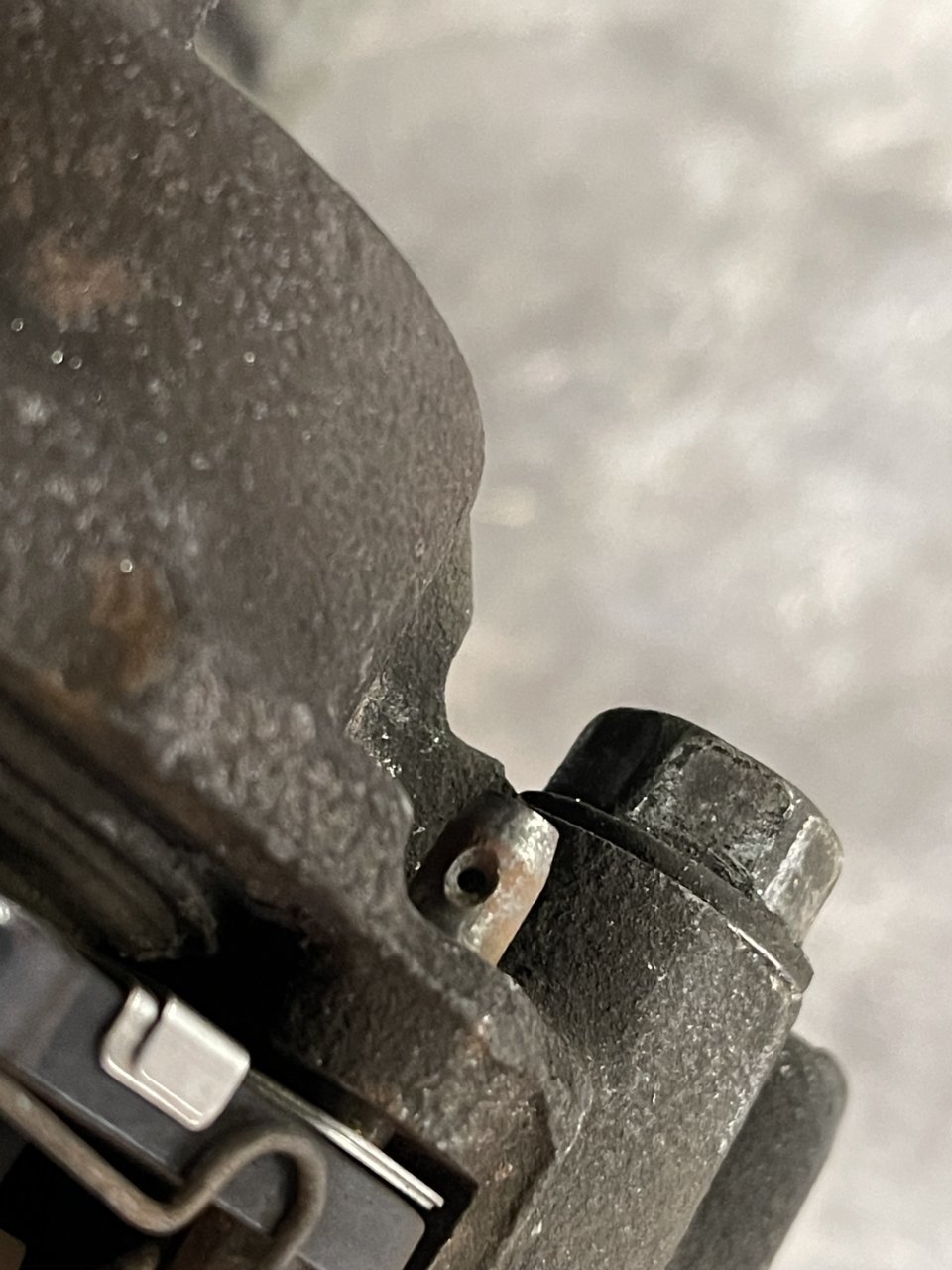

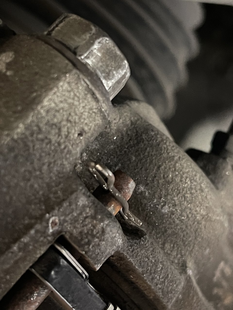

    Finally, the lower pin has no safety clip, and the only thing holding it in place is the rust.
    Is this normal? Is this safe?
    I mounted the wheel back and re-torqued the lug nuts, but didn't dare look at the passenger side brakes... not yet anyway. Thank you for your comments.

    The brakes look fine to me. Meaning the pads and rotors.
    yes, when I change the brake pads, I sand the pin and then apply grease on it, so it can move freely. And there absolutely should be a safety clip in both of the pins.
    can’t tell from the picture, but maybe that “spring” that pushes the pads apart….on the lower pin……is it rubbing against the rotor?

    You don’t really have to lube the whole pin.
    The pads won’t slide in towards the middle any further than then rotor.
    I lube the whole pin, it doesn’t hurt, and it’s “easier”.
    You think the dealer would have used new hardware. Yours looks old?

    I suspected as much (not having to lube the whole pin), but the contact area where the pin meets the caliper and perhaps the pad holder should be? Another concern of mine is that should the pin fall off or travel enough to cause play in the lower pad area, wouldn't that compromise the whole breaking mechanism? And yes, the pins don't cost that much... why wouldn't the dealer put new hardware in there while they were at it? I mean, I gave the the green light to do a complete front brake service.

    Make sure the wishbone shaped spring isn't rubbing on the rotors, that could make a squeal. Just buy a hardware kit to get that clip for the pad retainer.
    You shouldn't grease those retainers pins. They don't do it at the factory and it just attracts dirt. They just need to be clean and rust free.

    brake job done improperly
    safety pin assorted kit at harbor freight
    slide pins are to be cleaned and lubricated
    also, regarding noise
    you're supposed to do a bed in procedure. This cannot be done by the technician. New brakes must have at least 200 miles of regular driving put on them first, before doing a bed in.
    Which, is after they have been properly installed (yours are not)
    normally, the mechanic takes the pins out
    walks over with them to a bench grinder with a spinning wire wheel on it
    wearing safety glasses to protect from loose wire flying out
    and quickly cleans them to a shiny like-new condition
    before putting specific grease to aid in sliding, and corrosion protection
    is it safe? I've driven with a caliper falling off. Then fixed it. Yours is not that extreme but, it's not proper either.
    not high end brand
    not high end mechanics

    Most vehicles with disk brakes use what's called a "floating caliper" design where the caliper floats on a set of "sliders." These sliders allow the caliper to "float" laterally and they must be properly lubricated. If not - or if they freeze up - the pads will wear unevenly.
    Tacomas (and 4Runners) use what's called a "fixed caliper" design. This means the caliper does not move, but since something has to move, the pads float on the pins in the OP's pictures. Is one design better than the other? They both have advantages and disadvantages.
    I think what happened is the Service Writer used a generic write up that referred to a floating caliper design. Is the statement wrong? Yes, for a fixed caliper. No for a floating caliper. Should the pins be lubricated? The factory does not lubricate them. I just replace them every time I do the brakes.

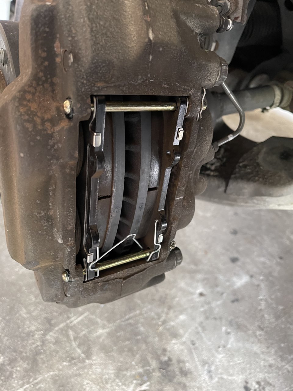

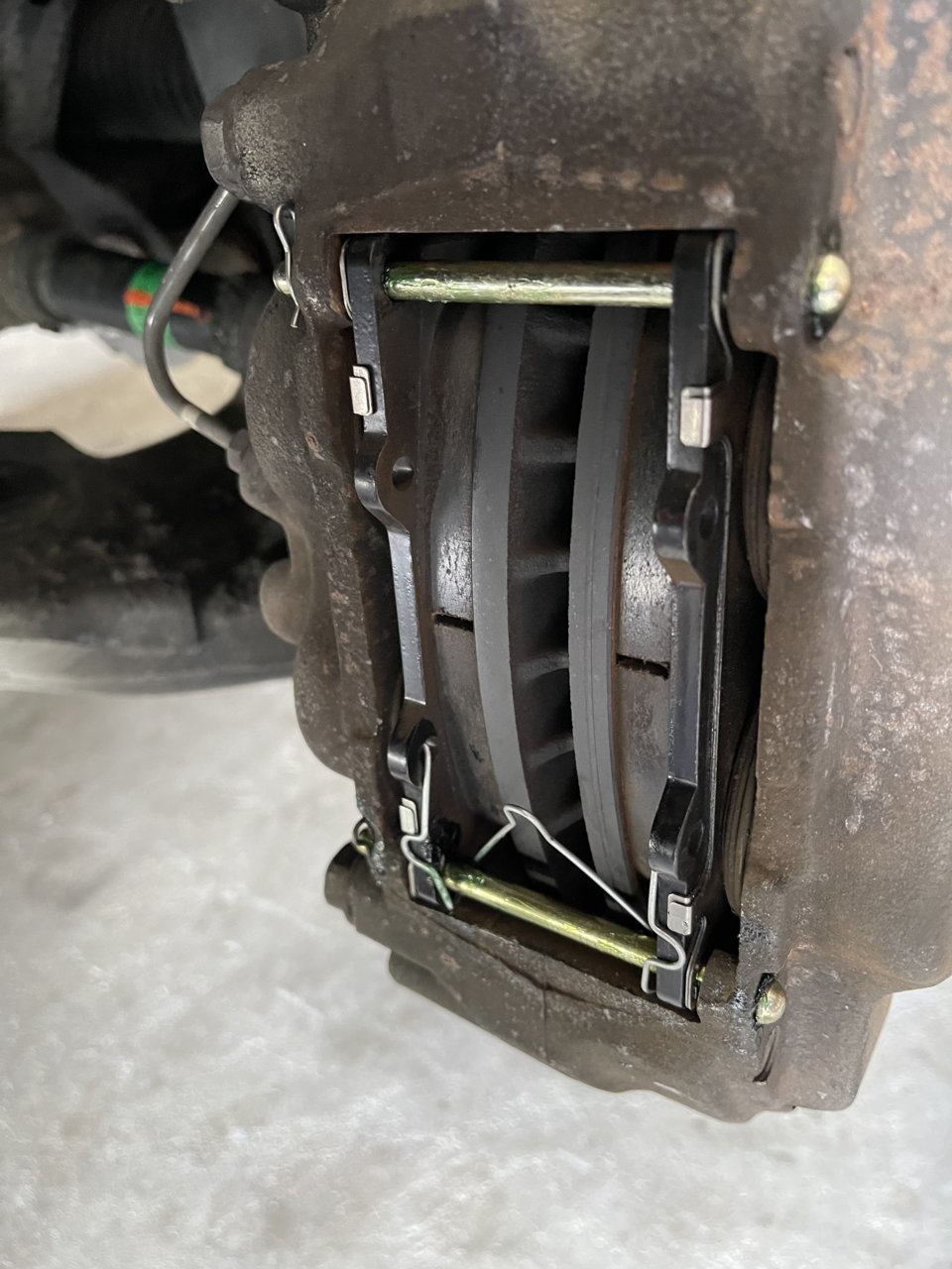

    Today I went to my local AutoZone and picked up two front disc brake hardware kits and two sets of guide pins, came back home and got to work. This is how things look like now:
    I lubricated the pins' contact points with this:
    This pic shows the (now) clearance between the anti-rattle spring and the pads:
    This is the front passenger side brake:
    Another view:
    And this is how it looks like now:
    The following pic shows the anti-rattle spring clearance:
    TacoTuesday mentioned that the pads need to be bedded in after a certain number of miles; I'll read up on the procedure and proceed to perform that when the target mileage is reached.
    I'll take a longish drive later this afternoon to see how things go.
