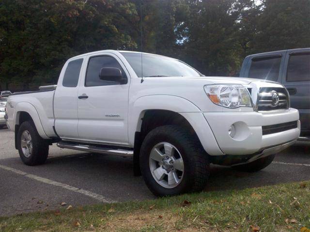

    Set your front billies at 1.75 and get a rear tsb done or equivelnet if you are out of warranty time. I did this with both my tacomas and had zero issues. It equates to a very nice leveling kit that almost looks lifted but looks like a virgin truck at the same time. :)
    Truck would look better with 285's these were 265/70/17 Nitto Teragrapplers
