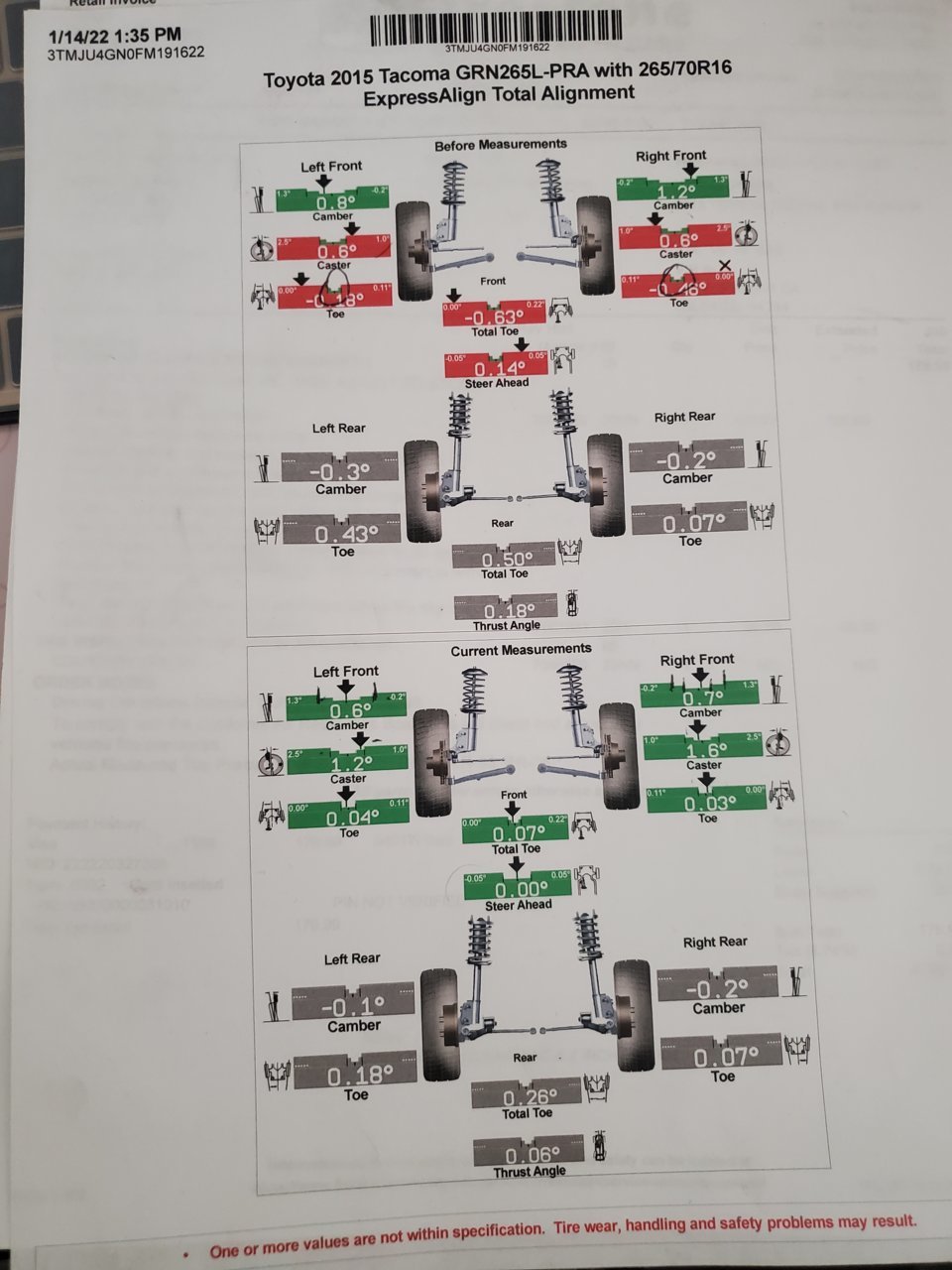

    Interested to hear this as well.
    Just installed 5100/884 & OME MD pack. I have the half in. spacer on driver side for taco lean.
    Prerunner dcsb with a shell on the back. Running 265 75 16 ko2's on stock trd or wheels. Everything else stock.
    So far have gotten about 2.5" of lift and truck is sitting fairly level to slight rake. Have only had the lift for about 200 miles.
    Took it to get an alignment, ended up with the numbers attached.
    I requested 0* camber, 0* toe and as much caster as possible, ideally at least 2.0*. Didnt seem like the shop really cared to try to dial those numbers in, they just got it "within factory spec" and stopped.
    As far as im concerned (and aware) i really only care about aftermarket uca (spc specifically) because i want to get more caster without sacrificing camber (even though camber is higher than I'd like it to be already).
    Unclear what I actaully "gain" in terms of ride quality by getting the numbers i mentioned above with aftermarket ucas.
    Edit: forgot upload image

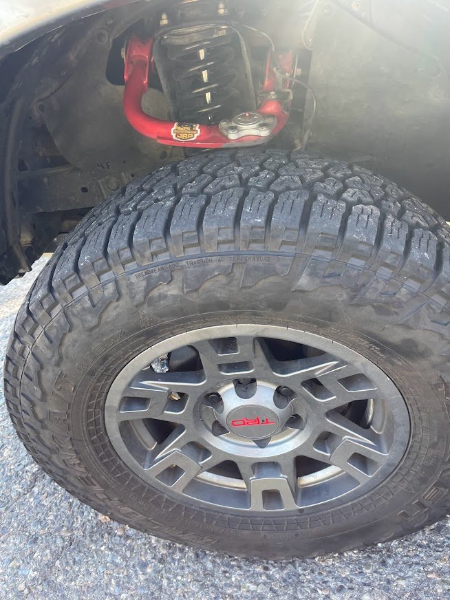

    Bilstein 6112/5160 OME Meduim leaf pack JBA HD UCA 3* retard exhaust gear TRD Pro Sema rims 265/70R17 Falken Wildpeak AT3W
    i was also under the impression that you need to upgrade the uca only to get the alignment back into spec. turns out i was wrong. sure i got more caster now (4*) but the biggest thing i noticed was the downtravel of my suspension. when ill be driving on a normal road i would hit a bump..so the wheel will go up, but on the way back down it would max out the ball joint on the uca and make a horrible noise.
    since i got the JBA UCA now installed, i dont have that anymore.
