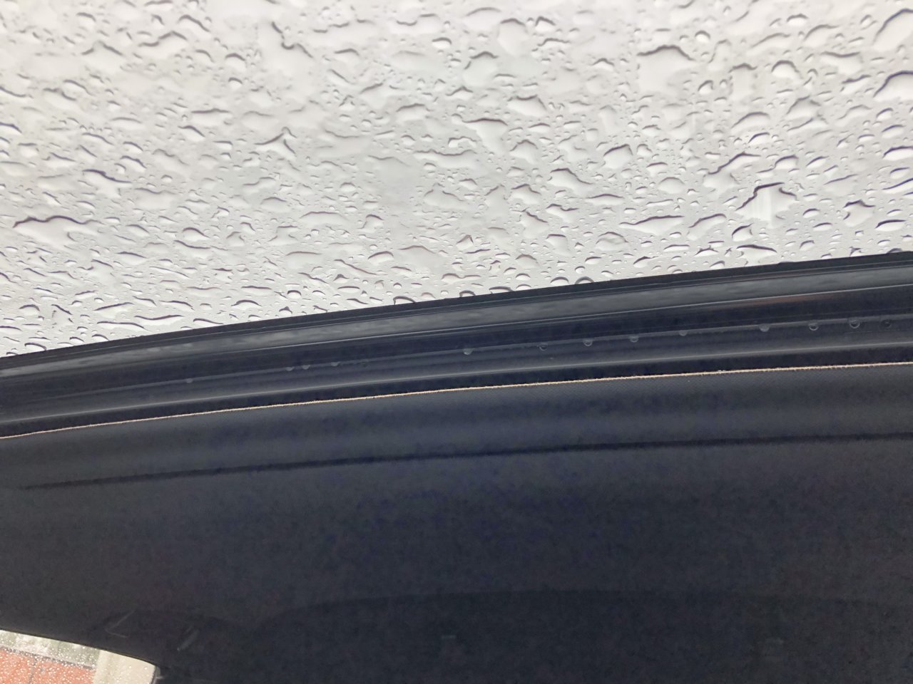

    2. Second issue I discovered prior to taking my truck in last time for the supposed diff howl fix is that I noticed my sunroof leaking when it rains. Turns out this is the 3rd brake light leak, which makes sense. The dealer confirmed when I asked that water comes in at the 3rd brake light and makes its way to the front of the cabin where the sunroof is. They supposedly replaced the seal on the light the last time but it still leaks the same amount. Now they are saying this is normal and that the water drops onto the drip tray, down and out of the truck. So, now they're saying its normal for the 3rd brake light to leak. Per the email: "If water is not coming into the passenger compartment, that is normal. The sunroof has a drip tray (gutter) that sends the water down the drip tubes." So now they're saying water coming into the truck is normal. Seems like another load of crap. See attached pic. Is this really normal? I discovered my brothers truck has this same issue. Other people with sunroofs, does yours do this? If so, have you done anything about it?

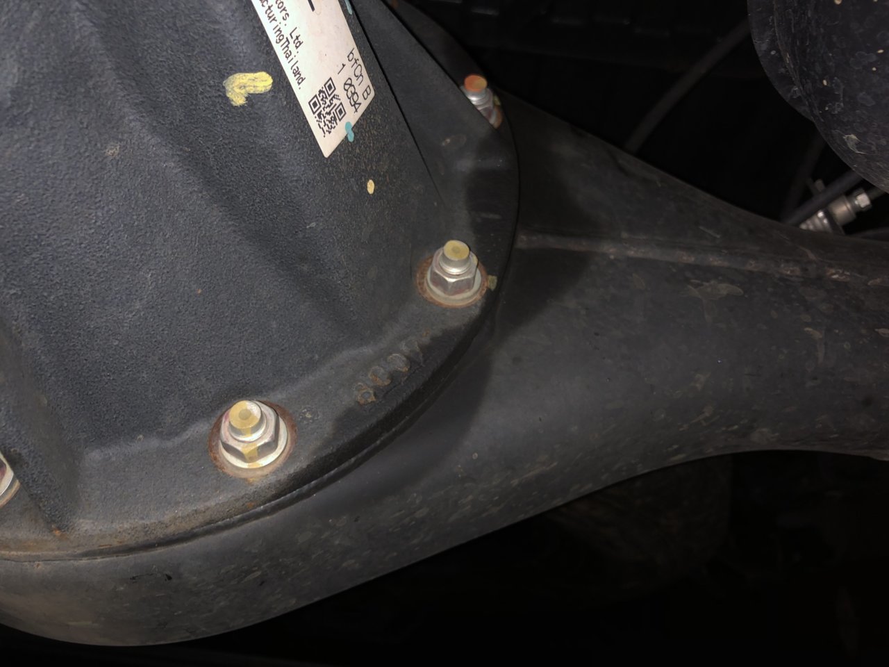

    3. Since I received this response I didn't care for, I got under the truck to see if my rear diff leaks. Sure does, on both sides. I haven't replied to the dealer yet to let them know I have the diff leak issue. See pics, seems fairly bad comparing the other diff leak pics I've ran across here.

    If that is water drops on the seal I see from the inside, as far as I'm concerned, that should be viewed as water leaking into the cab itself. Are you certain the leak is from the 3rd brake light?

    I hope it resolves the howl. I'm going to email the technician I've been working with today with pics of the diff and see what happens. I almost want to request a diff replacement, but I suppose I'll see how this plays out first.
    I believe they are correct about the 3rd brake light. Yes those are water droplets hanging down. They supposedly replaced the seal on the brake light last time it was in, but as much water comes in as before it seems like. The only reason I know is my wife and I purchased a new washer and dryer about a month ago. When we picked them up it was drizzling a bit. I backed partway into the garage so we could unload them. During this time it started pouring. I just happened to park with the back portion of the cab in the garage but the sunroof exposed and the sunroof didn't seem to let in any water. I'm with you, but I think they mean as long as it's not dripping on the interior then it's fine? It's really aggravating that they're trying to pass it off like it's supposed to be this way.

    lol water droplets hanging off there. just go in and spill a little bit of water down the side of the seat or on the floor. tell them its from the sunroof.

    I've never noticed water droplets hanging from my sunroof! Pretty sure that is not normal. It sounds like you need to see a different dealer honestly...
    My rear diff was leaking waaay less than yours was and I got mine fixed no questions asked the first time I brought it up to them.

    Same. The rear diff TSB is for the auto, but once I had the manager look at the diff himself (not just the tech), they replaced it w/o question.

    It’s normal for the sunroof to leak water into the gutter channels under high pressure like from a car wash. Under gravity conditions is not normal.
    The gear oil weeping out the rear end is due to improper torque on the nuts and will get worse over time that’s not normal. If the carrier wasn’t installed into the axel housing properly it’s reasonable to assume there are other issues in the rear end which explains the excessive noise.

    There are drain tubes for the sunroof that can get clogged with debris causing water to backup, sit and then leak. That's unrelated to the 3rd brake light leaking though. It could be both or one or the other in your case, but it's absolutely not normal that water gets into the cabin. If my dealer told me that, I'd immediately complain to Toyota Corporate or find another toyota dealer (I'm lucky that I have a few around me).

    Diff leak, same deal. Shouldn't be leaking, it's under warranty, work it out with the dealer.

    Very true. You can get a clogged drain tube the first week of ownership. I had an acorn get in one of the tubes once from being left open in the driveway. It's not a question if they will clog, it's when, all cars do. Not saying this is the problem but its easy to check the tubes. Open the roof, park the vehicle on a slight incline, pour water in the channel and it should drain both sides to the ground. Reverse truck in to slope the other way and repeat for other tubes.
    I had to use an air compressor on one vehicle once to clear my tubes. Ran a line down the tube as far as I could and shot it with air. Cleared right out. Crap builds up in them.
    The diff is an issue. It needs to be addressed.
    I use Permatex 81182 specifically designed for this on my other vehicles and it is the shi*. Would never take a cover off without it. I would be amazed if you had a leak using this stuff.
