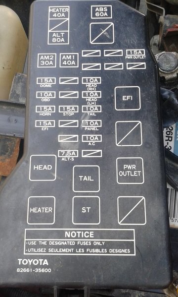

    I cant get my truck to start. My truck was running perfect before. But when id turn the key over in the ignition switch for the past five months its almost seemed like it takes a little longer for the engine to crank over after I turn the key. So that means it taking longer for it to ignite the gas.
    ...When I put my key in switch and turn it all the way over. The things that turn on and off by the ignition switch like the radio, built in clock, wipers, and windows do not work. Headlights, turn signals and speedometer and console lights all work..
    Tried shifting into neutral to roll it back to get it out the way and it won't let me. Takes the key turning over in the ignition switch to do this too. Which is why i think its my ignition and not my starter.. My starter, battery, and alt are all good. Checked them a week ago and tried another battery and it still didn't work plus my battery cranked up their car just fine. I cant quite hear the starter clicking over. But it may be too faint for me to hear. All my fuses checked out good in both fuse boxes. Haven't checked relays yet. How should I go about this and what could this be?

    Try another ignition relay

    Check for any burned wiring and ground connections are clean and secure, too.

    Sounds like you should probably due a tune up. Plugs, wires, test coils. Could be starter solenoid if its not even clicking.

    Which relay?

    Would any of this effect putting it into neutral?
