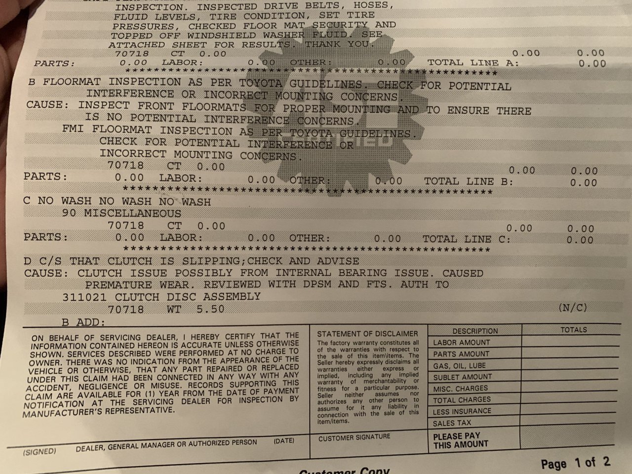

    I have a 2018 manual with 32 K miles, about 7K miles ago Toyota replaced the clutch pedal because of the squeaky noise, clutch pedal was not working correctly either, about 4K miles ago, I took my truck to Toyota for service and I pointed out to them there was something wrong with the clutch but they said there was nothing wrong. about 2 k Miles ago, I took mu truck to a different dealership and I told them the clutch was slipping, they said there was nothing wrong with the truck.
    Truck got to a point where is it a pain to drive it, so I took it to Toyota again today. They confirmed it is the clutch and it is not covered.....
    Anybody else with same problem? I've been driving manual for over 20 years, that is not normal with that mileage.

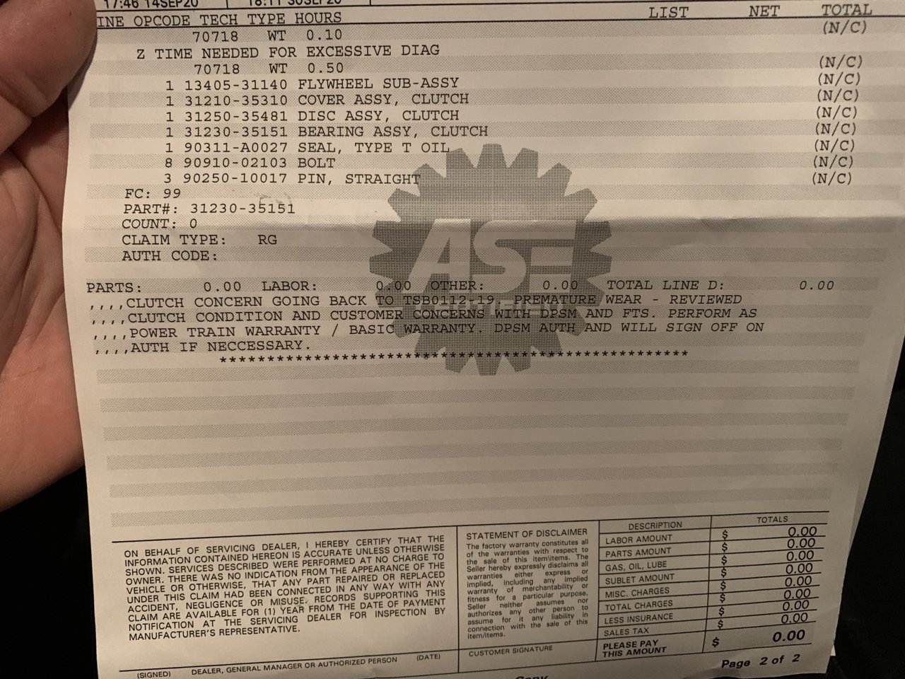

    Tacoma has rebuilt my clutch at no cost, once I pick up my truck tomorrow I will provide an update with back up of all the parts that were replaced.
    They gave me a hard time and I had to wait until a Toyota corporate supervisor came to inspect and check on the case but they admitted it was a Toyota problem

  17. Oct 1, 2020 at 6:45 PM
    #117
    valiant
    valiant Well-Known Member
    Dec 30, 2015
    #173558
    52
    TRD Tacoma 2015
    4A6DD135-202C-498A-BE50-4E44A45CC692.jpg 6E09E1D7-DFD9-40C1-B457-18FB84652EAF.jpg

    They got scared ... since u posted on tw lol .great they stepped up and fixed it .

    Yeap! They are a accepting they got an issue with the clutch and they are stepping up.
    just as advise for everybody, make sure you keep a record of your problem with Toyota and do not give up that easy, talk to different people at the dealership and also go to different dealerships.
    In my case, first I had to tell them about the TBS for the clutch noise, then I reported 3 times there was something wrong with the clutch and they’d aid there was nothing wrong until it the clutch was obviously gone! (Two different dealerships).
    Tacoma world was great information, my vehicle was not the only one with the problem.
