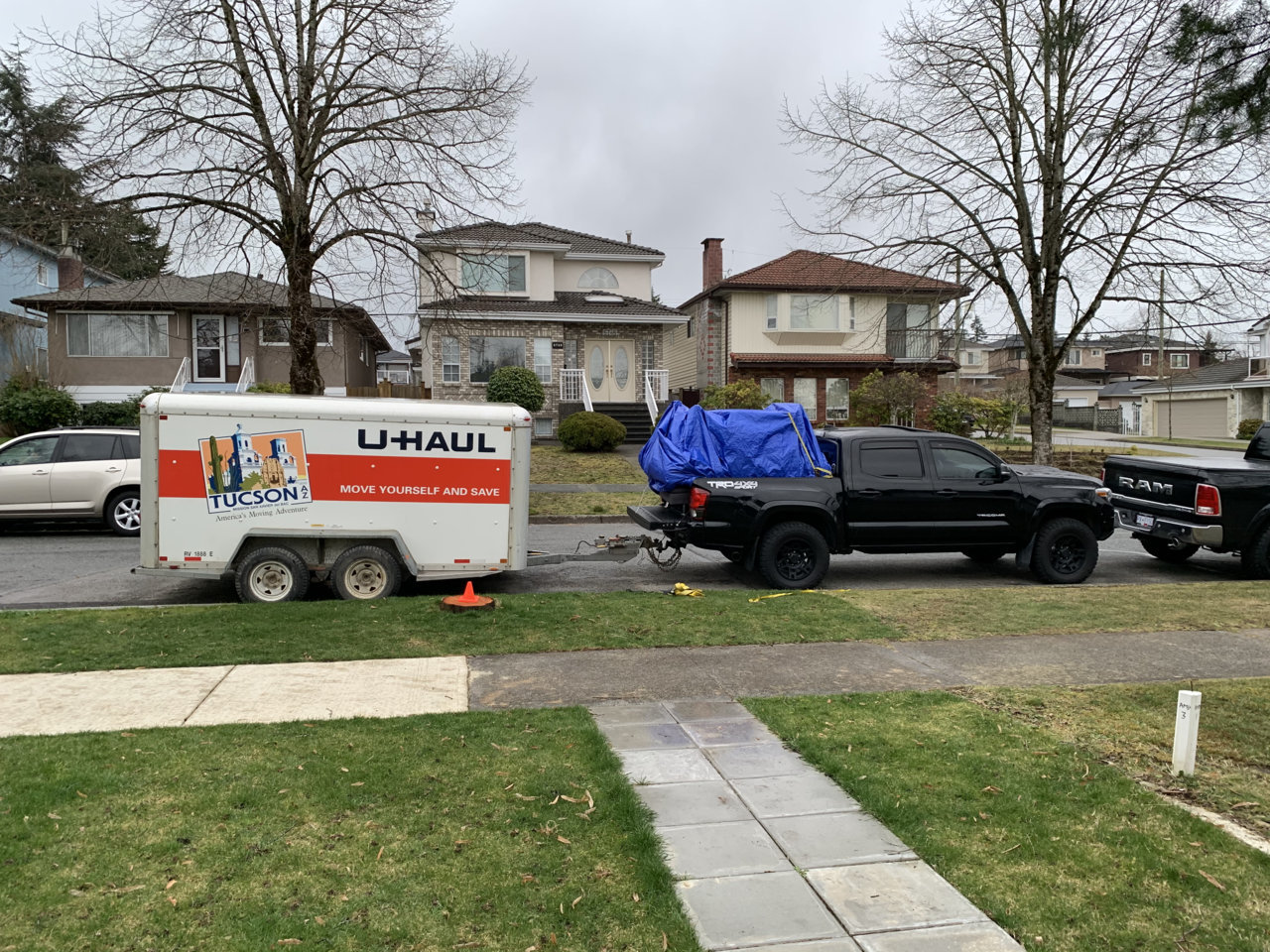

    Damn that sucks.
    I towed about 4500k pounds and taking off even on a slightest hill was no fun. I would not tow more than that where I live. On flat roads, no problem.
    I do spend quite a bit of time off-road in summers and my clutch still seems to be nice and smooth, hoping it will stay like that for many years.
    I did the ADM and it really helped with the consistency and feel of the clutch. Also, to me it seems like it would slip less without the accumulator.
    Actually I remember having a slight shudder when taking off on steep hills, then removed the accumulator and now it’s butter.
