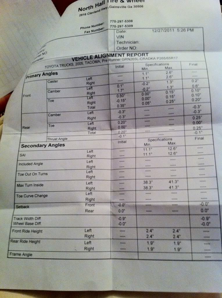

    yes theres one local i may look into it
    heres the sheet they gave me

    update the front was balanced but not the rears (only had 45 minutes to play with) steering wheel doesnt shake anymore but i can feel the same wobble in the seat im told its the rears that need to be rebalanced they were way off balance when i brought it back to them (after their initial balancing)
    the truck went on the alignment rack three times tonight and even thou the computer said it was aligned the truck still pulled to the left, im at a loss right now i dont understand how the alignment that was for the stock height worked better than the alignment they are using for the spacers which what i assume would be the stock measurements.
    how can spacers cause this much frustration with my alignment none the less the truck still has a vibration which im praying can be fixed by a rebalance
    side note** all three times the truck went on the rack the alignment was off, how can the alignment be off within 20 minutes and the computer be calibrated but still read that the alignment is off
