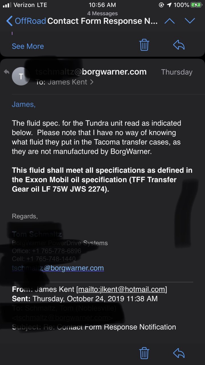

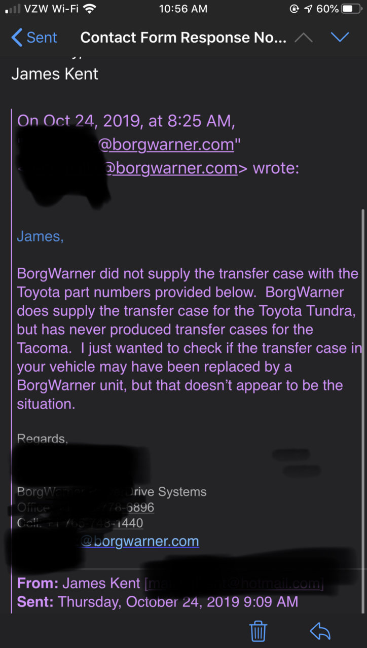

  15. Oct 27, 2019 at 3:17 AM
    #35
    You did what?
    You did what? Well-Known Member
    May 30, 2018
    #254934
    52
    James
    Ar.
    ‘16 TRD Off-Road
    I’ve been doing a lot of reading on this subject, here’s what I’ve discovered so far.
    They changed from a VF2BM to VF2CM transfer case in 2016 Tacoma’s . Difference in BM and CM ?? both are electric engage and they’re both Aisin cases. Borg Warner U.S. has not supplied cases for Tacoma’s, Tundras only, per Borg Warner. Aisin Sieki and Aisin Warner( alliance with Borg Warner) are majority owned by Toyota and produce the Transmissions and Transfer cases used. So is there some BW design/function used?, most likely.
    The LF75W is manufactured in Japan by Exxon for Toyota and is the recommended fluid for Tundra’s. I think they just blanketed others T-cases. In service manual for T-case assembly it says to coat parts in hypoid oil before assembling as well as using the 75w to fill with. So, is the LF 75w a hypoid oil?, why would you coats parts in a lube that’s not what it uses?
    I have a ‘16 Trd OR for now I’m using the Toyota fluid until I figure out what it is, I know it’s loaded with additives.

  18. Oct 27, 2019 at 8:54 AM
    #38
    You did what?
    May 30, 2018
    #254934
    52
    James
    Ar.
    ‘16 TRD Off-Road
    I see your point on the lube and assembly but, I was looking at it like not soaking bearings in motor oil or cam in grease. I generally use what oil/grease they operate with.
    As for the transfer cases and parts, I’ve not made it that far yet. I know that Aisin, Aisin Seiki have all merged into Aisin Warner which seems to have some relationship with Borg warner whether it’s sharing design, parts, function or all the above I don’t know. They (AW) will not answer questions about their products, they refer to dealerships and they (dealerships) call it a Toyota transfer case and that’s it. I’m still digging and just recently started this journey. Could very well be like Exxon and Mobil gas, different names and prices but break it down and it’s the same. BW denied anything to do with Tacoma transfer cases. Also I’ve spoke to several dealerships local and out of state and none uses the LF 75w oil, which is what started this for me 70789D83-303F-47DA-B956-4B3D0D7475C5.jpg
  19. Oct 27, 2019 at 9:08 AM
    #39
    You did what?
    May 30, 2018
    #254934
    52
    James
    Ar.
    ‘16 TRD Off-Road
    Borg Warner’s reply about the oil and I can’t turn up anything on it. 3454C413-7217-481A-89A0-8D3EA08649A3.jpg
