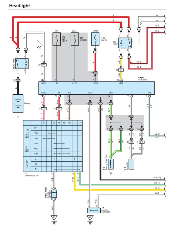

    It's the Body ECU. That is what controls the headlights.

    Thanks for chiming in guys. So...for the body ECU, do you suspect that it needs a reboot or that it is junk parts? Another question is what would make it go haywire? Just a coincidence with me installing the lighting controller or did I "cross the streams" somewhere?

    Check your powers and grounds at the body ECU before you condemn it, I've seen bad power and ground feeds cause some weird things to happen.
