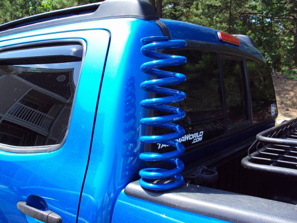

    On another note, looks like a pretty good color match, no? Soon to be rolling on Kingcon Vehicle Dynamics C/Os.

    I got ez-ups for my "garage". Winter rain sucks when working out back.
    Hope you like the 700#'ers :)
    I did a review for DSMS when I got mine last year or whenever it was. They started recommending them, then stopped due to complaints from owners saying they were to stiff. Personally I think my truck drives nicer then any of my friends that have 650#. Maybe one day Ill measure and see if they have sagged at all over the 30k I have on them.

    The 650s that came stock on the Icons are adequate...but just barely. I have the driver's side spring maxed out, and I'd be willing to bet they'll wear out faster than 700s.
    700s would be too stiff for most people - but when you have an extra 120lbs of bumper, 140ish of skids, and 80 or so of sliders, and you flex the shit out of the suspension often, you need that up front. For most of the web-wheelers on here, 650 is the right number.
    I don't have a permanent winch in bumper, so at least that's a bit less weight to worry about.

    I love mine:D Icon is who told me to go with a 700# 14" spring. The best part is I have hardly any preload on mine, so they don't hurt the down travel as much. They ride very nice IMO, even the day or so I drove around with them before my bumper was installed. I saw a few with the 650# springs with bumpers and they had a shit ton of preload. Can't say enough about them!
  20. Jun 24, 2012 at 2:43 PM
    #420
    jandrews
    jandrews [OP] Hootin' and Hollerin'
    Jun 7, 2009
    #18122
    16,432
    '09 FourDubDee TRD OR
    A-TRUCK, Fat Kid in the Bed, Custom Pinstriping, Ported and Polished Muffler Bearing, Hi-Performance Bed Mat
    Lift height is more what affects downtravel. Preload affects spring rate to attain desire lift height.
    Less preload will decrease chances of coil bind though, so that is nice...too much preload will cause coil bind during uptravel.
