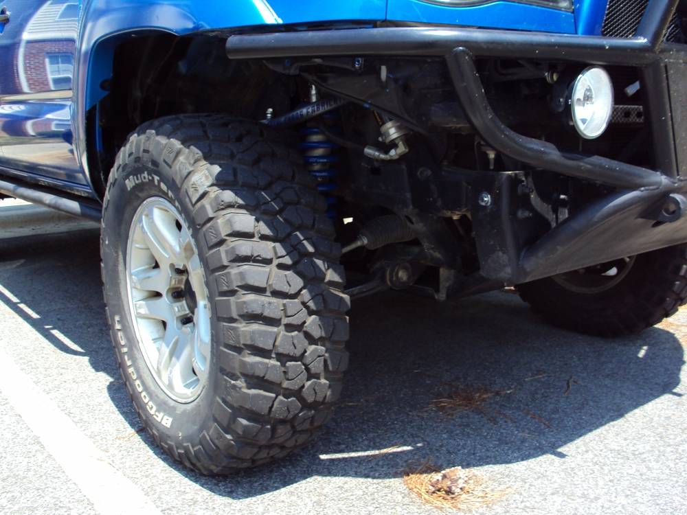

    Welp, got with Dbronzo yesterday and swapped the coilsprings and leaf packs out.
    Lesson learned: Don't use shitty auto-parts store u-bolts. I found out upon reinstall their washers did not have sufficient clearance to fully lock on the flip kit plate. This caused the ubolt heads to twist upon torqueing. I didn't have any choice, so I drove it home, albeit a bit worried.
    Went to Fastenal and picked up some hardened zinc plated shit and grade 8 washers to ensure the problem did not re-cur. Spent this morning re-doing the U-bolts and all is well now...
    Ass end is now about 41" ground to fender on a 33" tire. Hub to fender is 25". These Icon shocks are gonna have to go...they don't have enough travel to wheel this setup.
    Also, color matched coils yo! With the King 700lb coils, MUCH less preload needed. I got to 3.5" front lift with less than an inch of preload passenger side, and just over an inch driver side.

    Are you satisfied with the icons up front? You do the type of wheeling that I plan to, wondering how they perform crawling. Debating icons and kings
  12. Jul 8, 2012 at 9:37 AM
    #432
    jandrews
    jandrews [OP] Hootin' and Hollerin'
    Jun 7, 2009
    #18122
    16,432
    '09 FourDubDee TRD OR
    A-TRUCK, Fat Kid in the Bed, Custom Pinstriping, Ported and Polished Muffler Bearing, Hi-Performance Bed Mat
    I was working with a TSB pack with 2" wheeler's AAL. Those stock Toyota leafs went out quick. When I originally lifted I was thinking "I have perfectly good leaf springs now. Might as well use 'em."
    If I'd known they'd crap out so quickly, I'd have just gone to the Dakars then.
    If you armor the front, do what I did and put some King 700lb coils on the Icon C/Os. I like Icon's digressive valving better than King and Fox's progressive valving. That's a taste thing though. Everyone feels a little differently about it.
    If you're not going full skids, sliders, bumper, the 650lb springs that come with the Icons are fine. They'll technically work with all the armor (I ran that way for a year) but you'll have them preloaded to max, and I wouldn't try it with a winch living in your bumper as well.
