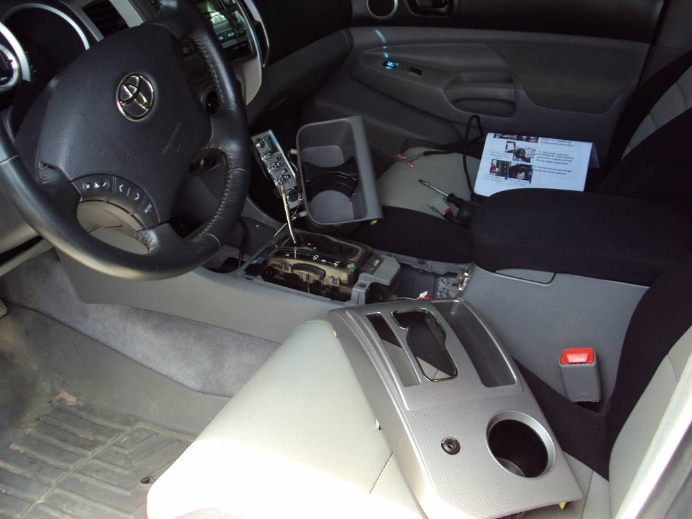

    Anyway, got the sPOD installed today. This reminded me how much I hate wiring stuff, even though this nifty little doohickey is almost like cheating. It makes the situation SOOOOOOO much easier.
    Basically, for those that don't know, it's a prebuilt relay block and wiring harness for 6 switches. All you do to install is:
    - Mount switches.
    - Mount sPOD.
    - Plug switch harness into switches.
    - Route switch harness to sPOD, plug in.
    - Route positive and negative connections from any accessory that draws less than 30amps to sPOD.
    - Connect sPOD to battery.
    Done.
    Here's what it looks like naked. It comes with a cover and mounting bracket. You can see the terminals for connecting accessories positive and negative on the left:
    The biggest challenge of the day was deciding where to mount switches. The sPOD is designed to use the factory blanks to the left of the steering column. The problem is, 2009+ TRD OffRoad models have no blanks. All those switch locations are used. So I tore open the interior for a while and looked around...
    There wasn't really any clearance behind most of the dash locations; Toyota has routed wiring in the spaces that aren't used by structural stuff. I ended up going with the center console next to the shifter. This necessitated some panel modification...
    An exacto knife helps if you want to use this location and retain the rubber insert for a nice factory look.
    If anyone else wants to try this method, piece of advice: Space the switches a little more than I did here. There was some interference between the top two switches and I had to dremel a couple millimeters off the bottom of the switch to get them to clear. There's plenty of unused space where I could've spread the switches out more. My own fault.

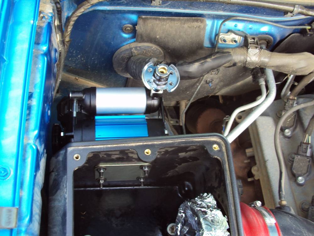

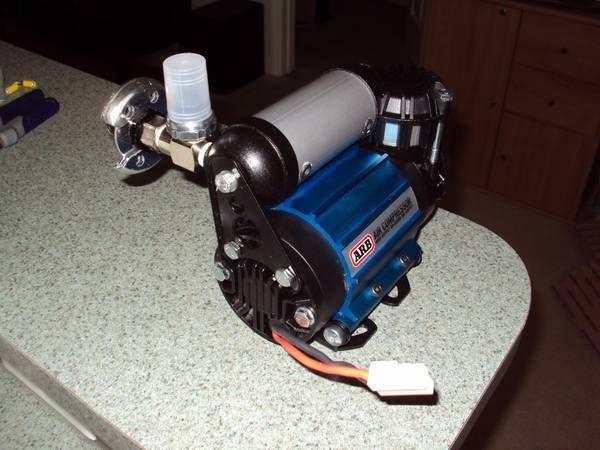

    Installed this little gem today.
    Looks innocuous doesn't it? It's not. It's like that bitchy girlfriend that you don't really want to keep dating but the sex is super good so you put up with her bullshit. What I mean is:
    http://www.youtube.com/watch?v=zwsIoZt6vGU
    http://www.youtube.com/watch?v=8GZuzlmpbOs

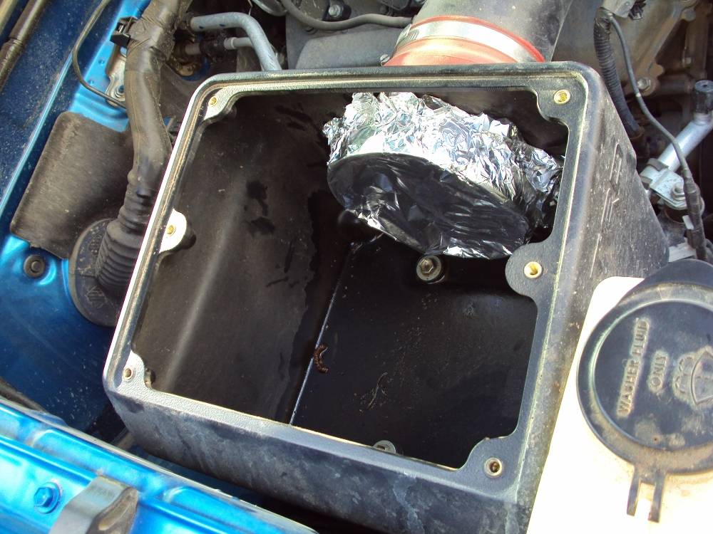

    Anyway, so I got out in the morning to scope mounting locations and find I'm in for some creativity. Most people mount by their air intake. Well that shit is out for me because of TRD cold air...the area normally empty is now occupied by the intake and the empty area where the stock intake WOULD be is extremely uneven and offers no flat area large enough to mount the ARB.

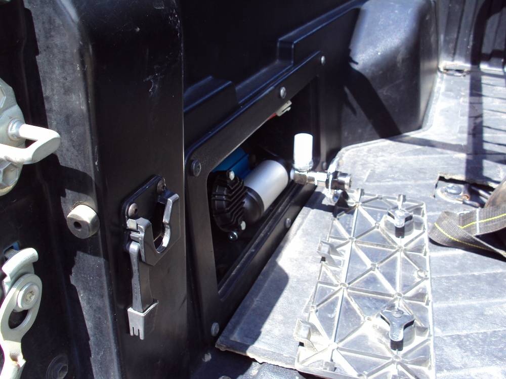

    I considered the cubby holes in the bed. It was not to be. The compressor with inflation adapter wouldn't fit without cutting, and cutting would open the whole cubby directly to the back of the rear driver tire...making for a quickly clogged compressor.

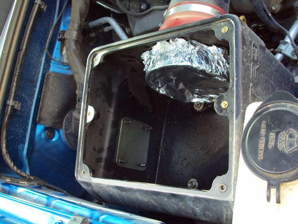

    So I decided, fuck it, let's mount it to the cold air intake.
    Remember kids, we're drilling here, so close your intake as to not get all kinds of shit in there:
    Looks good...
    That'll do, pig. That'll do.

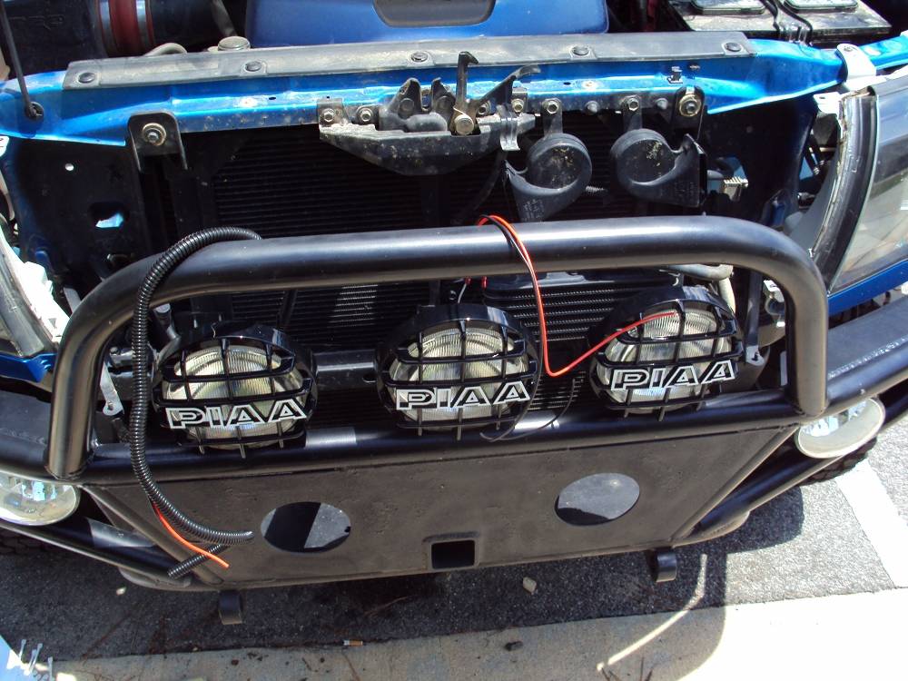

    I also got around to wiring my PIAAs up. More on that in a few hours when we lose some daylight. It's searingly bright out there right now. Did I mention I hate wiring?
