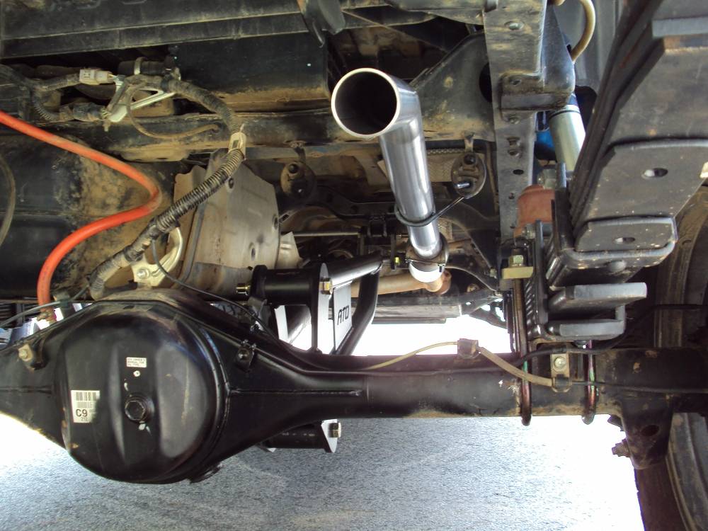

    Here's that other doohickey I was talking about...
    No more axle wrap baby! I think u-bolt flip kits make these trucks more prone to wrapping. Even with Dakars/D29XL I still had a little bit of clunk when braking to a stop. Not any more. This thing is a fucking monster, brackets made of 3/8" plate steel, 1/4" wall tubing for the bar, grade 8 hardware all around, and of course, fitted/trimmed/welded by you know who...
    I have some advice for new Taco owners seeking to seriously use their truck...just cut your stock exhaust off at the cats when you get the truck. You're going to replace it all anyway. This is exhaust reroute #2, muffler back.
    Before, I had already rerouted for the skid plates, now the TRD muffler was in the way of the trac bar articulating properly with the axle. It had to go. My local guys popped in a glass-pack to give me tons of clearance without adding any noise.
    Also, the trac bar kind of acts like a slider for the driveshaft, since it's so tough [​IMG]
    Oh yeah....and it's time to get those damn Dakars settling some so the truck isn't like 26.5" hub to fender in the rear...I have 200lbs constant with the rack, jack, spare tire, bedmat, bumper...another 200 or so should do it for a few weeks...

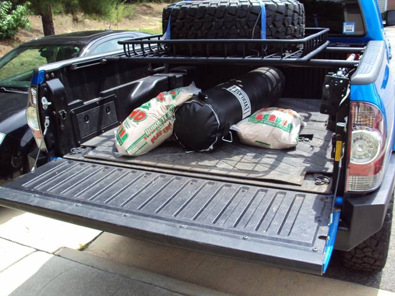

    RockyMtnTRD
    RockyMtnTRD Wanderlust.
    May 4, 2011
    #56088
    6,557
    Noah
    Colorado
    '11 TRD OR
    hack job
    What kind of bed bars / rack set up is that? Looks really nice on there, doesnt sit too high and allows you to use the bed still. Sweet.

    I've been looking for a trac-bar similar to that, is Kevin going to be mass producing them or just one off in house customs?
  13. Jul 25, 2012 at 8:56 AM
    #613
    jandrews
    jandrews [OP] Hootin' and Hollerin'
    Jun 7, 2009
    #18122
    16,432
    '09 FourDubDee TRD OR
    A-TRUCK, Fat Kid in the Bed, Custom Pinstriping, Ported and Polished Muffler Bearing, Hi-Performance Bed Mat
    I'm not sure on the history of the bed rack. I bought it from jhodge83. He bought it from some other member on here, I forget who. I believe that original member made the bed bars, and Hodge ordered the rack off e-bay...
  14. Jul 25, 2012 at 8:58 AM
    #614
    jandrews
    Jun 7, 2009
    #18122
    16,432
    Ask him. Far as I know, I'm the first person to ask him for one.
    ಠ__ಠ
    I'll be having a truss welded to the rear of the diff to protect the weak spot. The underside doesn't need any help.
    Diff diapers decrease clearance and that's about it IMO.

    Will do, looks like he used the Ruff Stuff kit as a base then built up the bar itself!

    hah, i was right in my guess :) i remember us talkin bout that at one point too. first time i saw the pic, first thought to me was Trac Bar

    Correct. RuffStuff base, Kevin built the bar and trimmed the ruffstuff brackets to perfect fitment to the 2gen Taco since the RuffStuff kit is "universal" (as long as you have a welder and grinder/plasma cutter :laugh:)
