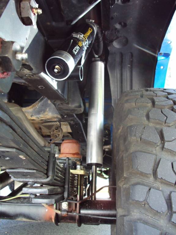

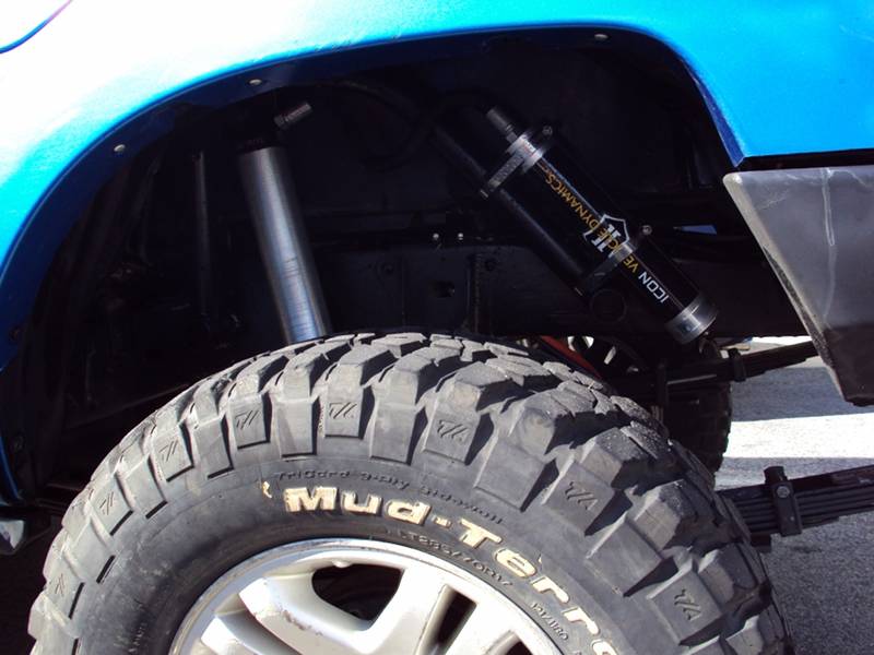

    Alright, shock mounts.
    First off, let me recommend that no one ever try this. If you want to relocate your shocks, go with a 2.0 monotube, not a 2.5 remote resi like my dumb ass.
    The original plan was to approach the clearance issues by fabbing mounts below the axle and kicked out into the wheel with the brake drum. This has been done on some other rigs and worked out well. The lower mount is protected from trail debris by the wheel itself. An example:
    (Photo by Drew02)
    Problem: 285 tires. They put the sidewall in so close to the leaf spring perch you can't get sufficient angle in the lower shock mounts to kick them into the tire without the shock body getting clobbered by the leaf spring during suspension travel.
    This might still be doable with a 255 width tire and 2.0 shocks. I'd love to see someone try.
    That said, here's what we ended up doing: Going traditional. Mount those fuckers high and put the bottom mount flush with the bottom of the axle. Right now, with my 4.75in backspace and +15mm offset wheels (goddam), the tire sidewall gets into the shock body at full stuff. I have a new set of wheels coming from SCS Performance with 4.3in backspace and -10mm offset. That should take care of the problem.
    Extended brake lines are also on the truck now. Crown performance hooked me up with lines made for 7 inches of rear lift. Suffice it to say, my brake lines are not a worry anymore.
    Thus:
    I will probably have another bar added further back as a resi mount in the future. Right now the zip ties are necessary to keep the resi hose from popping out into the tire. Changing the resi mount location will solve that.
    I like that the shocks are about the same diameter as my bumpstops :laugh:
    These things look pretty monstrous lurking in the fender wells. They mean business....once I get my new wheels :eek:

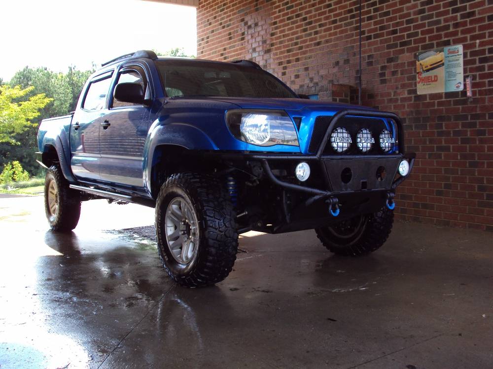

    And, since we did a shit ton of grinding, of course the truck needed a wash afterward...

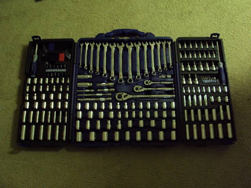

    Oh, I also scored a 200pc. mechanic's toolset at Lowes. They were clearancing some of their older Kobalt tools, and this set was sale priced at $100. Normal price was $180. I couldn't not buy it at that price. Kobalt tools aren't Snap-On or Matco, but they're better than most of the horrendous shit being sold out there these days, and at 50 cents a tool, that's a steal.

    Also, as far as I know, this is the first set of 2.5" OD/15in travel shocks that've been stuffed under a 2gen taco without
    a) cutting the bed
    or
    b) putting the lower shock mounts below the axle
    Someone let me know if they know of anyone else that's managed to get something that size under there. I'd love to compare notes with 'em.
