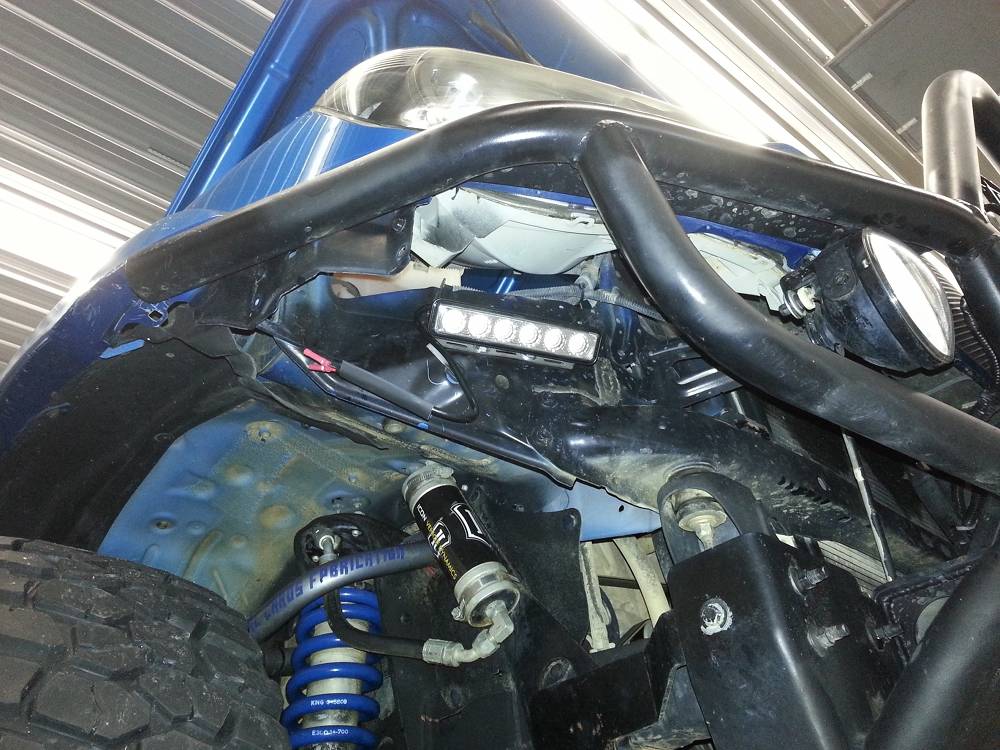

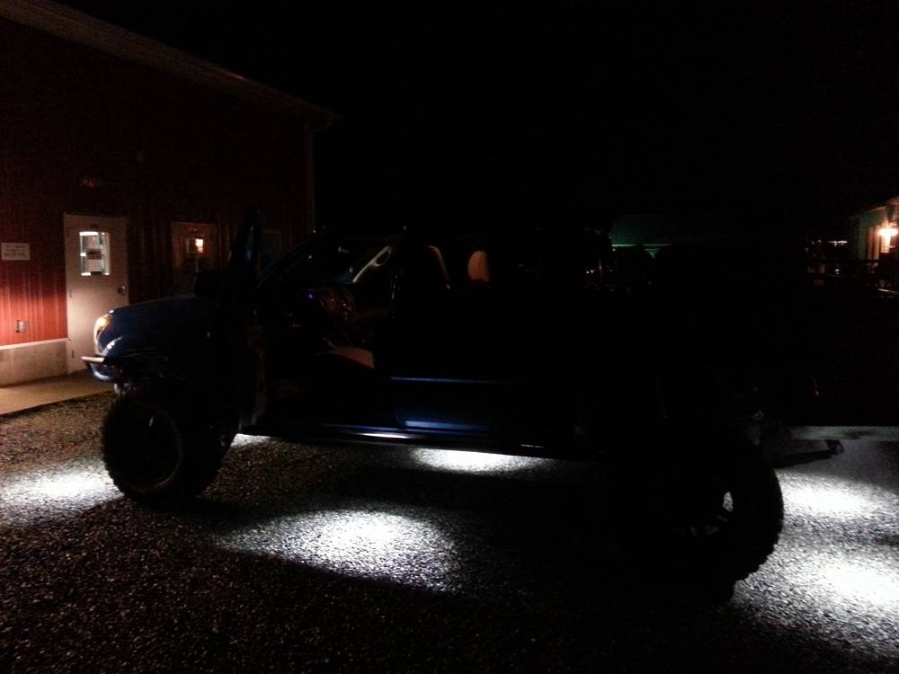

    Rock lights are in.
    It became immediately apparent upon receiving the shipment that Blitzpro's included mounting hardware was some kind of comedy. It is in no way adequate. We drilled the mounting brackets and used our own 7/16s bolts/nuts/washers.
    Front lights are drilled and mounted into the fender sheetmetal, mids are mounted in holes punched through the frame (well above slider level of course) and rears are mounted to the rear of the frame well above bumper level.
    Output is excellent.

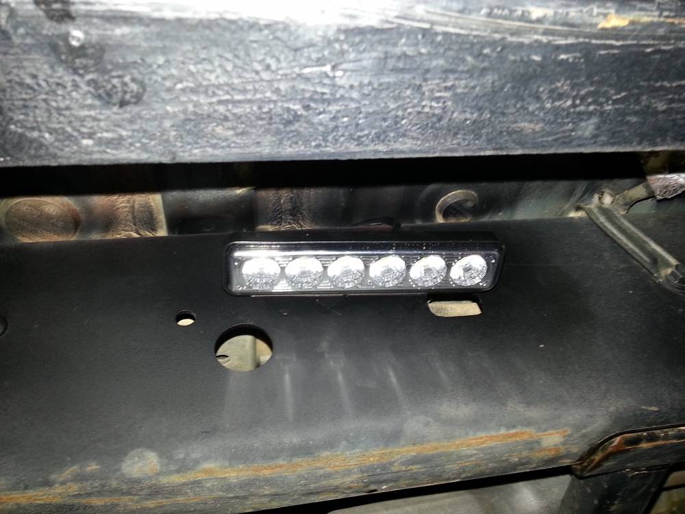

    Fronts are outside the fender sheetmetal. Those of you with plate front bumpers will not be able to take advantage of this location:
    Mids are halfway down the frame. Drill frame, paint, done:

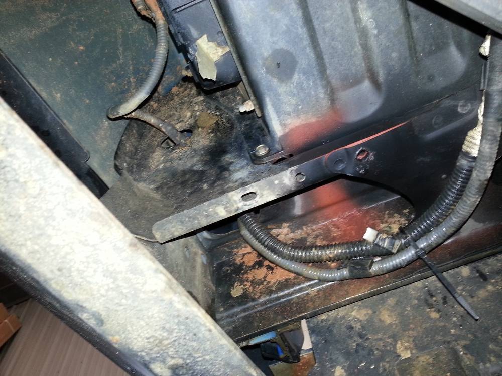

    For the rears, there's a lip of the rear frame crossmember that already has some stock wire loom in place. I removed those clips, re-routed the stock stuff, and drilled an additional hole on each side to go with the existing hole. This isn't the mounted light, and as you can see I was in the middle of priming and painting, but the drilled hole is on the right.
