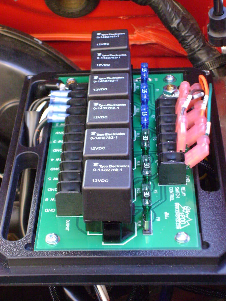

    It's a full kit man.
    $345 shipped got me:
    - Pre built fuse block and relay bank. 40A relays, 3x30A fuses, 3x15A fuses.
    - Mounting bracket.
    - Cover.
    - Wire harness for switches.
    - 6 switches.
    - They included a bunch of zip ties, heat shrink, and spade terminals.
    All you do is mount the sPOD, mount your switches, run the wire harness through the firewall and plug the switches in. Then you run + and - from accessory to the sPOD. Then connect the sPOD to the battery. Any accessory up to 30A per rail. It's seriously fucking cheating.
    Some guys say it's better to go with the homebrew stuff, but I know for a fact most of them have $200 to $300 in their setups when it's all said and done and it takes them a LOT longer to wire up the fuse block/relay block on the bench.
    Also, all the fuses and relays are plug and play, so if you do blow one, you can just pull it and replace it right there on the trail. That also reminds me I need to pick up a few spare relays and some spare fuses before my next trail trip. Has a 50A inline circuit breaker from the battery, and low-voltage cutoff as well, so if your battery gets below 10.6, it'll cutoff your accessories before you drain out. It's the best option out there by far I think.

    That S-Pod is seriously awesome.

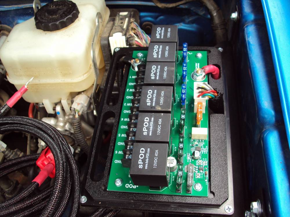

    i do like how they went to a connector for the part of the harness that goes to the switches. alot better than how mine is. also, on mine, the LVCO isnt built in. it used to be seperate

    Made it a (slightly) easier install, but it also requires you to write down/remember which color wire on the harness goes to which switch. With your setup, you can change switches just by joggling the spades around.

    yeah, mine had switch numbers labled on both sides of the wire. but yours has the LVCO, mine doesnt
