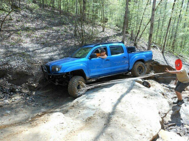

    Trac bar is on the right of the shaft. Rock came from the left.
    As for not liking decreased OD, I think if it's thicker wall and damn well balanced it'd be fine.
    I'd think .120 wall would be sufficient.
