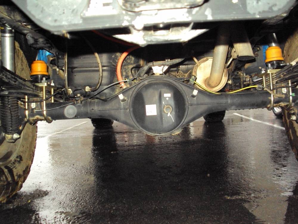

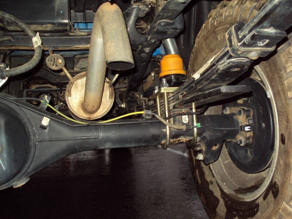

    U-bolt flip kit, superbumps installed today. Also wailed the pinch weld down flat.
    Pics of the rear axle stuff forthcoming.
  12. Feb 28, 2011 at 4:36 PM
    #132
    jandrews
    jandrews [OP] Hootin' and Hollerin'
    Jun 7, 2009
    #18122
    16,432
    '09 FourDubDee TRD OR
    A-TRUCK, Fat Kid in the Bed, Custom Pinstriping, Ported and Polished Muffler Bearing, Hi-Performance Bed Mat
    Here's the new SuperBump and flip kit setup. Thanks to LarBoogrnr for grinding and drilling the biatches out.

    Have you tested your new flex with the shackle flip done yet? Just curious if the shock length has changed a ton at full compression and droop. I'd like to do the flip too. Also do the factory bumpstops work with the ubolt flip?
  14. Mar 1, 2011 at 3:47 AM
    #134
    jandrews
    Jun 7, 2009
    #18122
    16,432
    There is no shackle flip on the truck.
    I'm not really worried about travel changes - the superbumps compress to the same height as the stock bumpstops, so travel is pretty much the same. You lose a hair on the rear axle because the u-bolt plate places the bumpstop higher on the axle. That's ok by me...with the stock bumpstops I was having the rear tires rub the fenderwell at full stuff. This should be about perfect.
    Yes, the factory bumps work fine with the u-bolt flip.
    I see no reason why shock travel would change at all...
