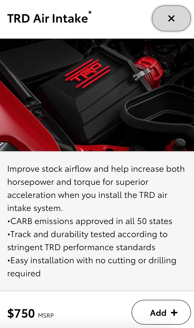

    Anyone think the TRD air intake will help? Toyota states it improves hp & torque.

    Did they say how much it improves hp and tq?
    Nikitin[QUOTED][OP] likes this.
