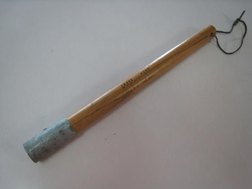

    You just gotta find an old fashioned trucker's tire thumper.
    FL1dQgZZutsX72DNen_htiHycoXWySSC49gWOWYa_10a0420164c92c1ea1cc4fde3fcd21a6f4df1d33.jpg
    I inherited my grandad's. He claimed he found it on a jobsite where they were converting the old asylum wing into a new county hospital. It has teeth indents in it.
